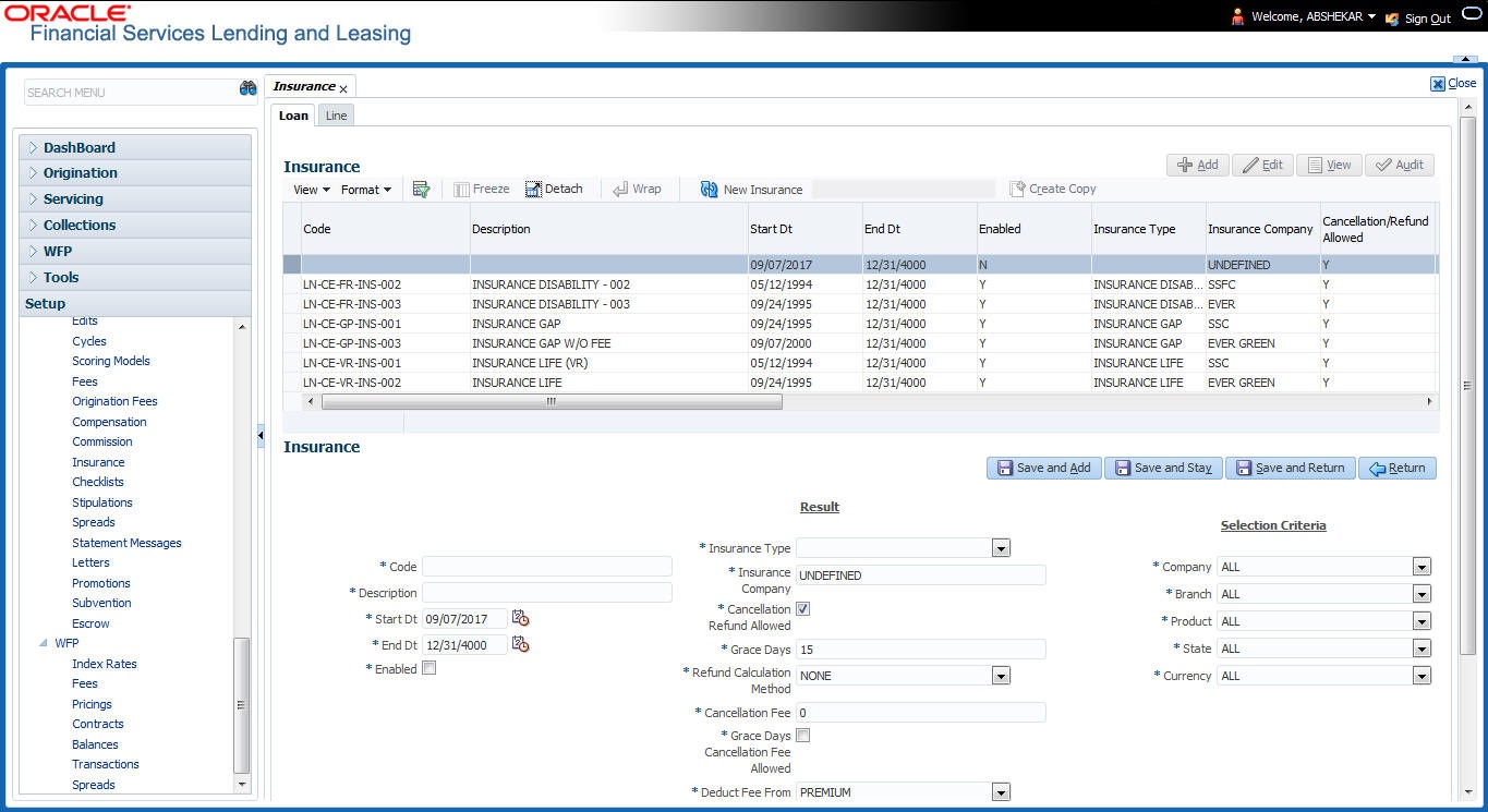

You can either define new Insurance details or specify a new code in the New Insurance field and click Create Copy to create a copy of selected insurance with details.
  1. On the Oracle Financial Services Lending and Leasing home screen, click Setup > Setup > Products > Insurance > LoanLineLease.
  2. In the Insurance Definition section, perform any of the Basic Operations mentioned in Navigation chapter.

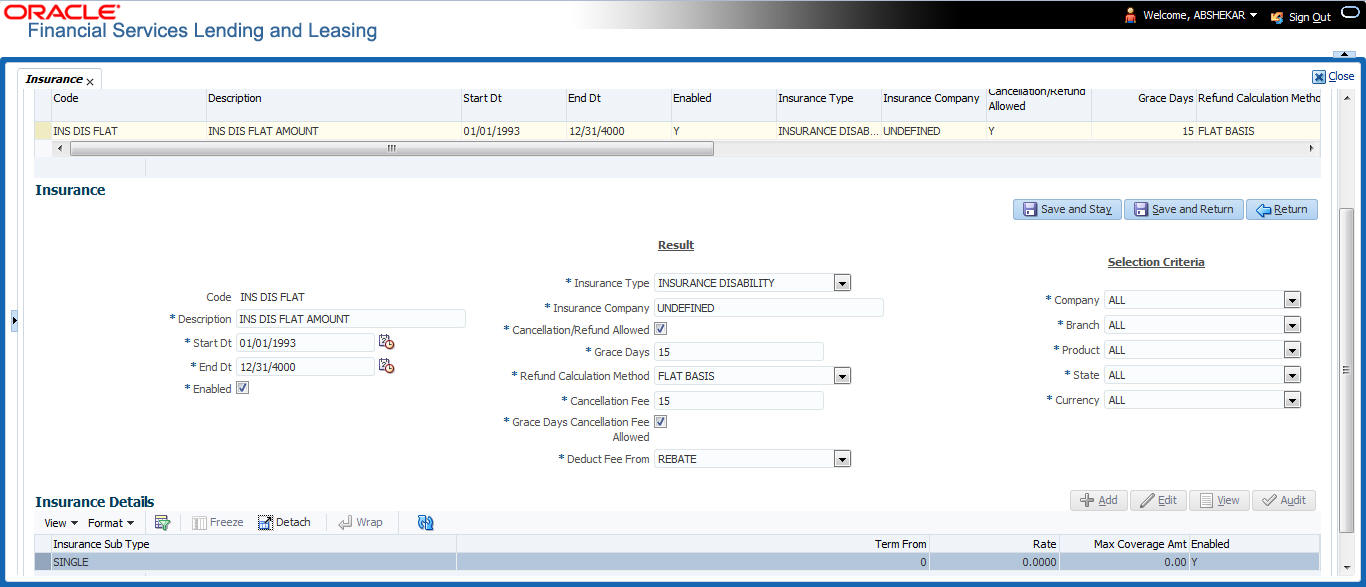

    Refund Calculation Method Select the insurance premium refund/rebate calculation method to be used when insurance is cancelled, from the drop-down list.
    Cancellation Fee Specify the amount of the cancellation fee to be charged when the insurance is cancelled.
    Grace Day's Cancellation Fee Allowed Check this box to allow cancellation fees during grace period.
    Deduct Fee From
    Select one of the followings option from the drop-down list to deduct the cancellation fee:
    Premium amount - which is deducted upfront before computation
    Rebate amount - which is deducted after computation

  3. Perform any of the Basic Actions mentioned in Navigation chapter.
  4. Click Create Copy button in the Insurance Definition section to create copy of selected record with details.
  5. In the Insurance Details section, perform any of the Basic Operations mentioned in Navigation chapter.

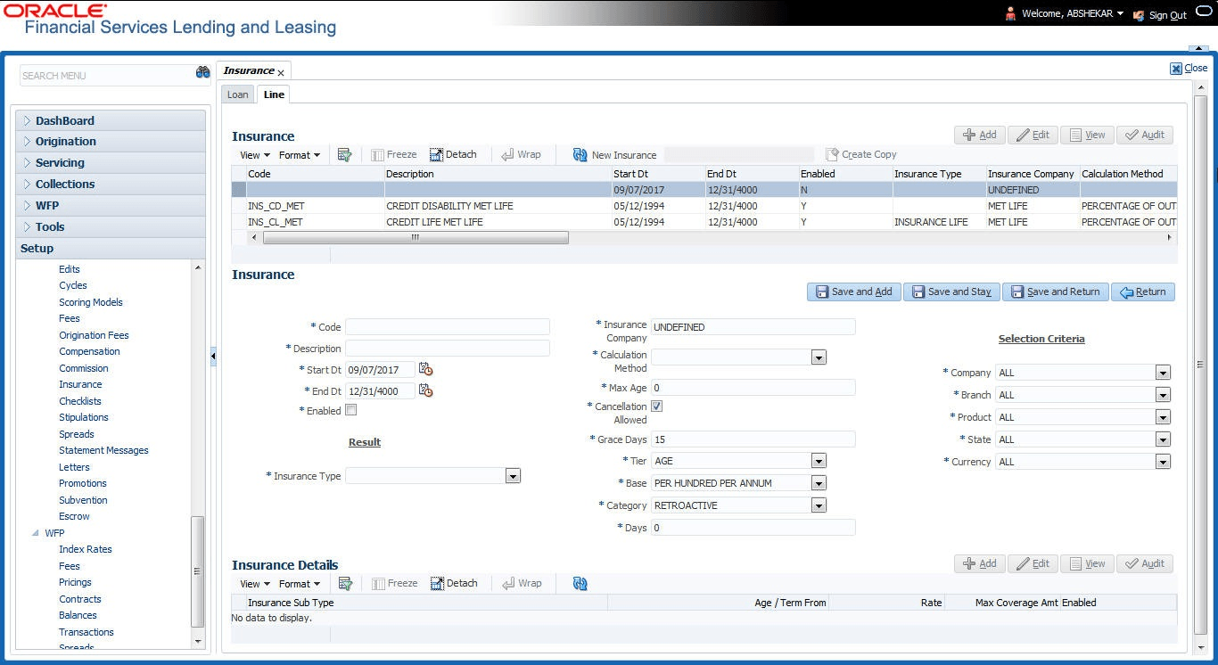

    A brief description of the fields is given below:
    Table 4-60 Insurance Details
    Field Do this
    Insurance Sub Type Select the insurance sub type you want to define for the entry in the Insurance section, from the drop-down list. For example SINGLE.
    Term From Specify the minimum term for the insurance sub type.
    Rate Specify the rate for premium calculation per $1,000.00 for the insurance sub type.
    Max Coverage Amt Specify the maximum coverage amount covered by the insurance sub type.
    Enabled Check this box to enable the insurance.
  6. Perform any of the Basic Actions mentioned in Navigation chapter.
