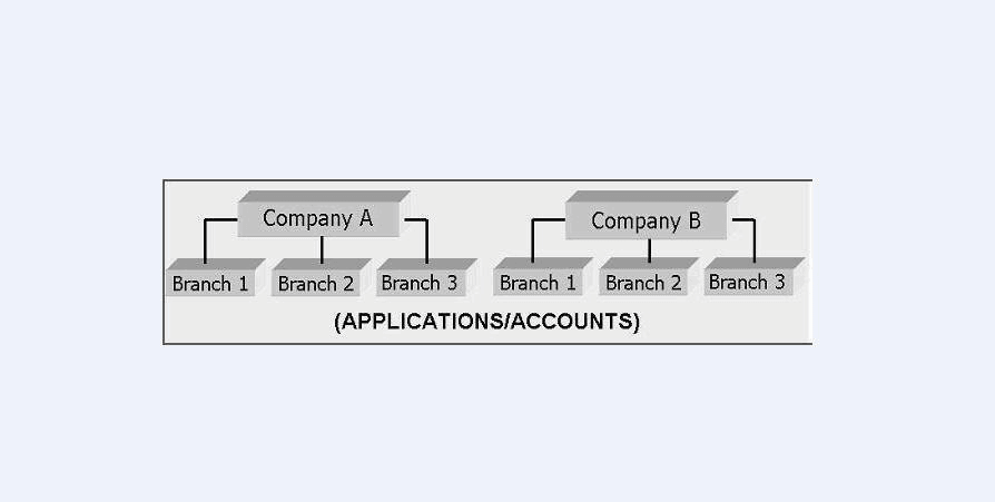

The Companies screen records the hierarchical structure of your portfolio companies and their branches. Just as Oracle Financial Services Lending and Leasing uses the Organization screen to determine the location of people, it uses the information on the Companies screen to determine the location of applicationsaccounts. In completing the Companies screen, there can be more than one company, and each company can have more than one branch.
Accounting is performed at the company level. applications accounts can be sorted down to the branch level. For this reason, branches are set up to reflect different business practices. You would set up different branches if, for example:
  • The General Ledger (GL) differs between branches
  • The branches work with different accounts
  • There is a difference between branches in terms of the tasks they perform (origination, servicing, collections, and so on).

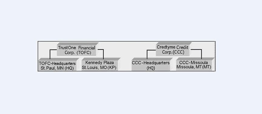

    As an example of the companies setup, Oracle Corp. might have the following companies and branches defined as:
    Company: C-0001TrustOne Financial CorpTOFC
    Branch: CB-01TOFC - HeadquartersHQ
    Branch: CB-02Kennedy Plaza KP
    Company: C-0002Credtyme Credit CorpCCC
    Branch: CB-11CCC - HeadquartersHQ
    Branch: CB-12CCC - MissoulaMT
    • The system does not limit the number of companies or associated branches with the company you can enter.
    • The Short Name field on the Companies screen allows you to create the ID that the system will use while referring to the company and branch.

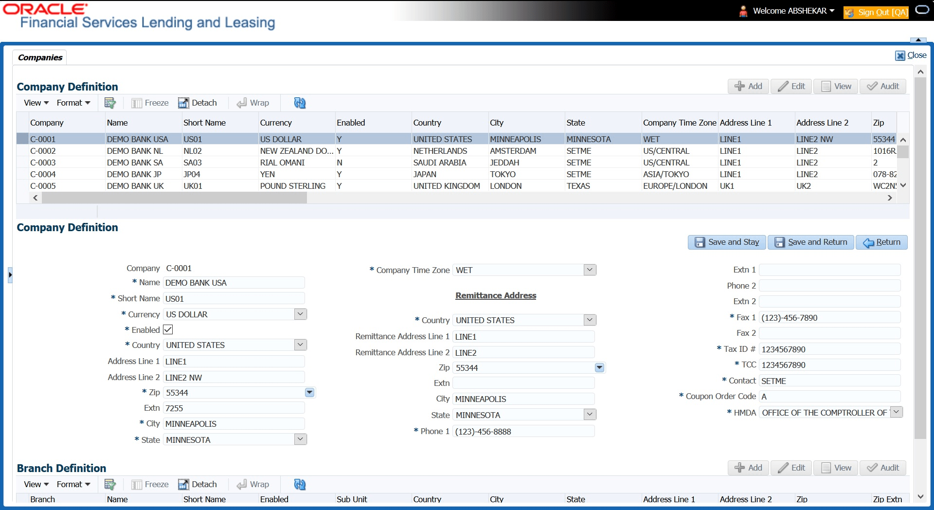

    To setup the Companies
    1. Click Setup > Setup > Administration > User > Companies. The Companies screen defines entities within your organization that originate and/or service LoansLeasesLine of Credit.
    2. In the Company Definition section, perform any of the Basic Operations mentioned in Navigation chapter.
      A brief description of the fields is given below:
      Table 3-5 Company Definition
      Field Do this
      Company Specify the portfolio company ID. (This ID is the unique identifier used internally by the system to represent the company).
      Name Specify the name of the portfolio company (required).
      Short Name Specify the short name for the portfolio company (ID displayed to represent the company).
      Currency Select the currency of the portfolio company from the drop-down list. The system displays the default value as US DOLLAR.
      Enabled Check this box to enable the portfolio company.
      Country Select the country where the portfolio company is located from the drop-down list. The system displays the default value as UNITED STATES.
      Address Line 1 Specify the address line 1 for the portfolio company.
      Address Line 2 Specify the address line 2 for the portfolio company.
      Zip Select the zip code of the location where the portfolio company is located from the drop-down list.
      Extn Specify the extension of the zip code where the portfolio company is located.
      City Specify the city where the portfolio company is located.
      State Select the state where the portfolio company is located from the drop-down list.
      Company Time Zone Select the time zone in which the company operates using the drop down list. This time zone is considered if system is setup to process GL at Company level. For more information, refer to Appendix - Configuration at Company Level chapter.
      Remittance Address section
      Country Select the remittance address country from the drop-down list. The system displays the default value as UNITED STATES.
      Remittance Address 1 Specify the remittance address line 1, if it is different from the company address. This address is included as the remittance address on statements.
      Remittance Address 2 Specify the remittance address line 2.
      Zip Select the zip code of the remittance address line 1 from the drop down list.
      Extn Specify the extension of the remittance address zip code.
      City Specify the remittance address city.
      State Select the remittance address state from the drop-down list.
      Phone 1 Specify the primary phone number for the portfolio company.
      Extn 1 Specify the phone extension for the primary phone number.
      Phone 2 Specify the alternate phone number for the portfolio company.
      Extn 2 Specify the phone extension for the alternate phone number.
      Fax 1 Specify the primary fax number for the portfolio company.
      Fax 2 Specify the alternate fax number for the portfolio company.
      Tax ID # Specify the tax identification number for the portfolio company.
      TCC Specify the transmitter control code for the portfolio company (1098 Electronic Filing).
      Contact Specify the contact information about the portfolio company.
      Coupon Order Code If you are using coupons, Specify the coupon order code to be used by a third party printing the coupons for billing statements.
      HMDA Select the HMDA agency (Home Mortgage Disclosure Act reporting agency for the company).
