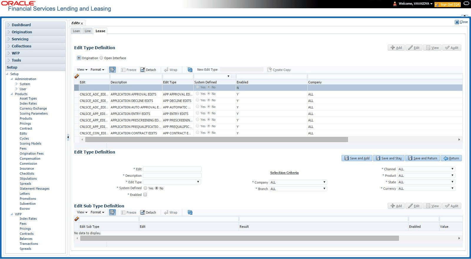

To set up the Edits
You can either define new Edit Type Definition details or specify a new name in the New Edit Type field and click Create Copy to create a copy of selected edit type definition with details.
  1. On the Oracle Financial Services Lending and Leasing home screen, click Setup > Setup > Administration > User > Products > Edits > LoanLineLease.
  2. On the Edits screen, choose Origination or Open Interface.
  3. In the Edit Type Definition section, perform any of the Basic Operations mentioned in Navigation chapter.
    A brief description of the fields is given below:
    Table 4-30 Edit Type Definition
    Field Do this
    Edit Specify the edit name.
    Description Specify the description for the edit.
    Edit Type Select the edit type code from the drop-down list.
    System Defined Select Yes, if the entry is system defined. System defined entries cannot be modified. Select No, if the entry is not system defined and it can be modified.
    Enabled Check this box to enable the edit.
    Company Select the portfolio company associated with this edit, from the drop-down list. This may be ALL or a specific company.
    Branch Select the portfolio branch within the company associated with this edit, from the drop-down list. This may be ALL or a specific branch. This must be ALL if you selected ALL in the Company field.
    Channel Select the channel from the drop-down list, This can be ALL or a specific channel.
    Product Select the product associated with this edit, from the drop-down list. This may be ALL or a specific product.
    State Select the state with this edit from the drop-down list. This may be ALL or a specific product.
    Currency Select the currency associated with this edit, from the drop-down list. This may be ALL or a specific branch.
  4. Perform any of the Basic Actions mentioned in Navigation chapter.
  5. In the Edit Sub Type Definition section, perform any of the Basic Operations mentioned in Navigation chapter.
    Table 4-31 Edit Sub Type Definition
    Field Do this
    Edit Sub Type Select the edit sub type for the edit, from the drop-down list.
    Edit Select the description for the edit, from the drop-down list.
    Result Select the result type for the edit, from the drop-down list.
    Value Specify the expected value for the first edit. The Value field records the threshold value for the edit. The actual function of the entered value is dependent on the edit category.
    Override Responsibility Select the responsibility that can override the edit, from the drop-down list, if the edit result is an override. Designates the user responsibility level required to continue processing applications that fail the edit based on the Value field. You may define the same edit multiple times with a Result = OVERRIDE and different Value and Override Responsibility combinations to encompass various results.
  6. Perform any of the Basic Actions mentioned in Navigation chapter.
