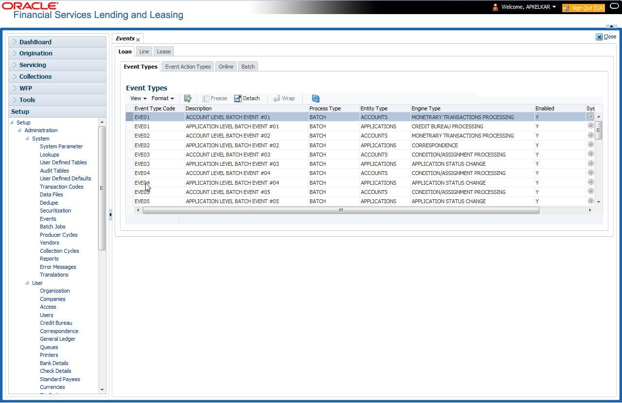

2.11.1.1 Event Types
- Click Setup > Setup > Administration > System > Events > LoanLine of creditLease > Events Types.
- In the Event Types tab, you can view the existing events and its details maintained in the system.
A brief description of the fields is given below:
Table 2-39 Event Types
| Field | Do this |
| Event Type Code | View the event type code. |
| Description | View the event description. |
| Process Type | View the event action processing type (BATCH or ONLINE). |
| Entity Type | View the entity type (ACCOUNTS or APPLICATIONS). |
| Engine Type | View the engine type (MONETARY TRANSACTIONS PROCESSING, NON-MONETARY TRANSACTION PROCESSING, CONDITION/ASSIGNMENT PROCESSING, APPLICATION STATUS CHANGE, CREDIT BUREAU PROCESSING, LETTERS PROCESSING or CORRESPONDENCE). |
| Enabled | Y indicates event type is enabled and N indicates disabled. |
| System Defined | If Yes indicates that the event type is system defined. If No indicates that the event type is user defined. |
