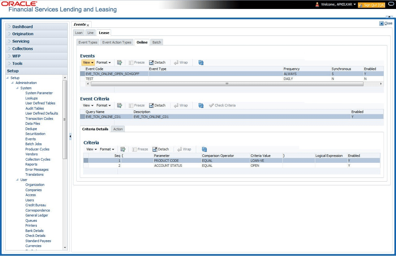

To view Online Event
Click Setup > Setup > Administration > System > Events > LoanLine of creditLease > Online.
A brief description of the fields is given below:
Table 2-41 Online Event
Field Do this
Event Code View the event code.
Event Type View the event type.
Synchronous S indicates that the event is synchronous (i.e. any failure in triggering the event will fail to trigger the entire transaction). If A indicates that the event is asynchronous (i.e. any failure in the event will not affect the transaction, which will be successfully completed).
Enabled Y indicates event type is enabled and N indicates disabled.
The Event Criteria section allows you to view the query defined for an event.
Table 2-42 Event Criteria
Field Do this
Query Name View the query name.
Description View the query description.
Enabled Y indicates event criteria is enabled and N indicates disabled.
Criteria Details
The Criteria Details sub tab allows you to view the defined selection criteria for the event. System uses these criteria to determine which application account to include in the event action.
Although system allows to define customized selection criteria, the execution of additional selection criteria requires additional processing at server level and can have significant performance impact delaying the EOD processing/web services. Hence it is recommended to have careful consideration while defining the additional selection criteria (like using user-defined tables and columns) and/or get approval from your database administrator before using any selection criteria.
Table 2-43 Criteria Details
Field Do this
Seq View sequence number.
( Indicates opening bracket.
Parameter View the parameter selected for the criteria.
Comparison Operator View the comparison operator selected for the criteria.
Criteria Value View the criteria value.
) Indicates closing bracket.
Logical Expression View the logical operator selected for the criteria.
Enabled Y indicates event selection criteria is enabled and N indicates disabled.
