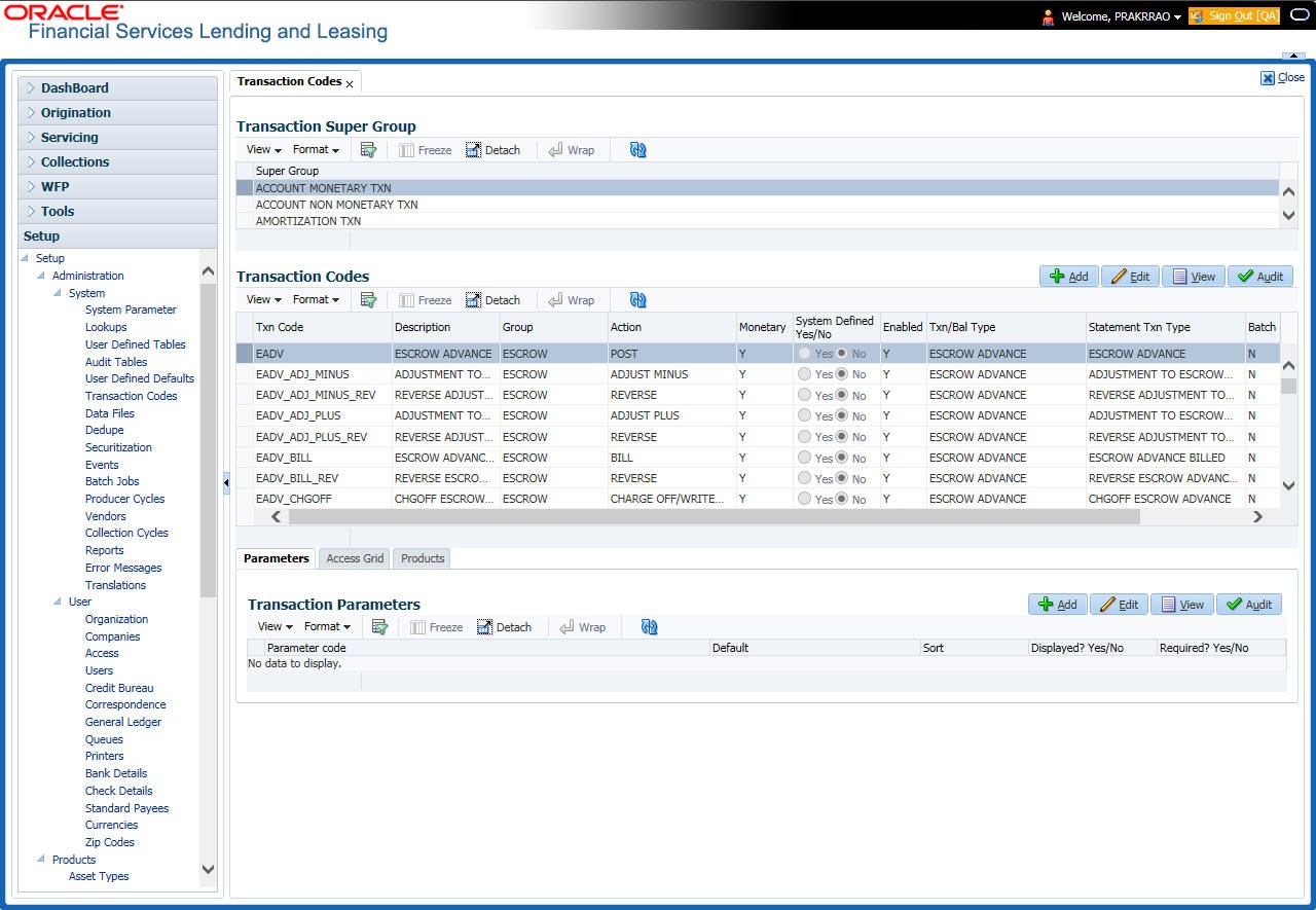

  1. Click Setup > Setup > Administration > System > Transaction Codes. The system displays the Transaction Codes screen.
  2. In Transaction Super Group section, you can view the following information.
    Figure 2-10 Transaction Super Group
    A brief description of the fields is given below:
    Table 2-21 Transaction Super Group Fields
    Field Do this
    Super Group Select the Super Group you want to work with in the Transaction Codes screen.
  3. Perform any of the Basic Actions mentioned in Navigation chapter.

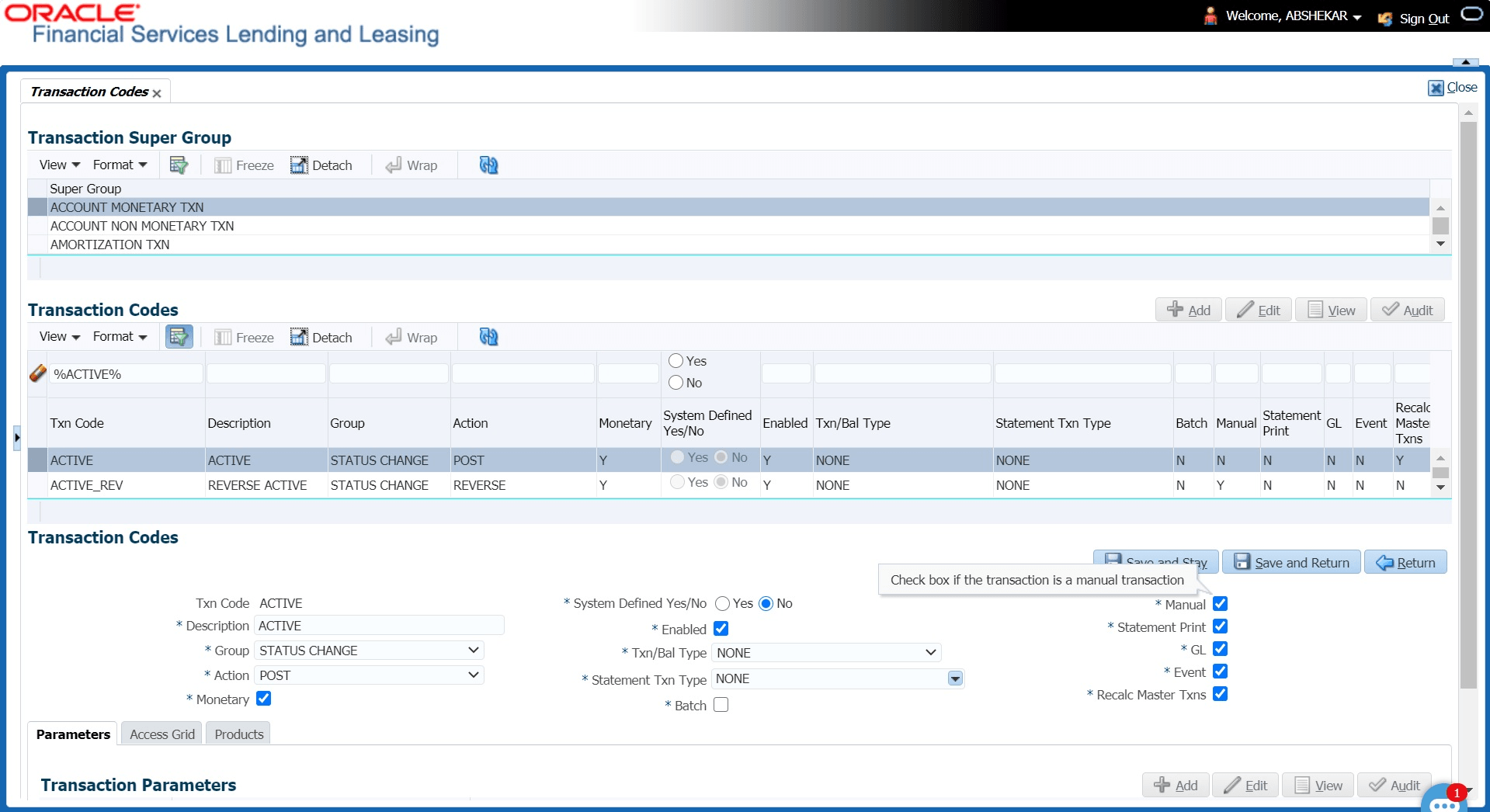

  4. In the Transaction Codes section, perform any of the Basic Operations mentioned in Navigation chapter.
    Table 2-22 Transaction Codes Fields
    Field Do this
    Txn Code Specify the transaction code (required).
    Description Specify the description for the transaction.
    Group Select the transaction group (the group within the Transaction Super Group that the transaction code belongs to) from the drop-down list.
    Action Select the action type code for the transaction (what action will take place when the transaction occurs) from the drop-down list.
    Monetary Check this box to maintain the transaction as a monetary transaction. If unchecked, then the transaction is nonmonetary.
    System Defined Yes/ No Select Yes, if you wish to maintain the transaction code as system defined and No, if you do not want to maintain it as system defined. System defined entries cannot be modified. If entry is not system defined, then it can be modified.
    Enabled Check this box to enable the transaction.
    Txn/Bal Type Select the transaction / balance type affected by the Transaction from the drop-down list.
    Statement Txn Type Select the statement transaction type (how the transaction should appear on the customer statement) from the drop-down list.
    Batch Check this box to perform the transaction in a batch process.
    Manual Check this box, if the transaction is a manual transaction. If you define a transaction as manual, the system recommends that the transaction that reverses it also be defined as manual.
    Stmt Print Check this box to print the transaction on customer statements.
    GL Check this box, if the transaction is a general ledger transaction.
    Event
    On selecting this check box, the particular Monetary/Non-Monetary transaction is considered for triggering of respective Monetary and Nonmonetary transaction posting Event type. The particular Monetary/Non- Monetary transaction is available while defining Event Actions.
    For more information, refer to Events (New Framework) section.
    Recalc Master Txns
    Check this box for system to recalculate and repost consolidated fee at Master Account level. This is done automatically by identifying those monetary transactions which should trigger recalculation of Late Charge, Cycle Based Late Fee and Cycle Based Collection Late Fee at Master Account level when backdated transaction is posted on any Associated Account that is marked for fee consolidation.
    For more information, refer to Cycle Based Fees and Fee Consolidation sections in Contract setup screen.
