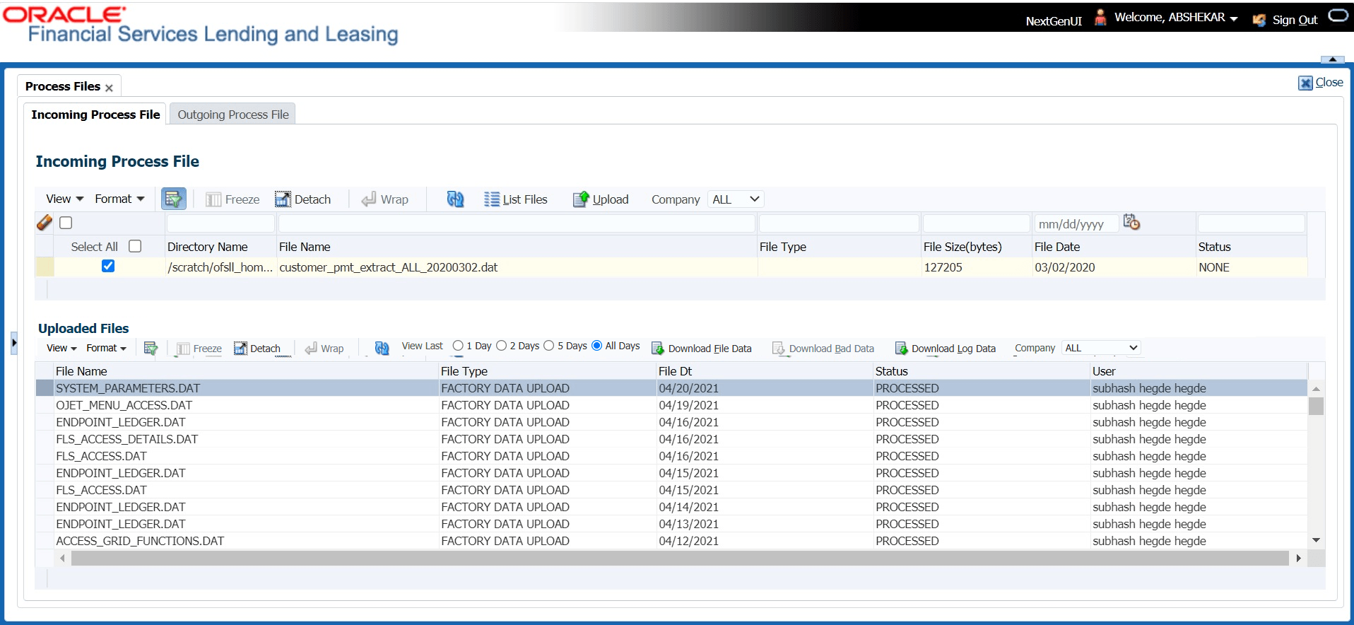

2.6.1 Incoming Process File
The incoming process file screen displays the list of files being shared from an external system along with other attributes such as directory path, file name, type, size, date and status. You can select the file required and upload it into the system for immediate processing.
View the list Incoming Process File
- Click Dashboard > Process Files > Incoming Process File.
- In the Incoming Process File section, click List Files. System displays the list of incoming files.
A brief description of the fields is given below:

System supports Account conversion via API files and can be uploaded through the Incoming file upload web service. Ensure that CMN_FILE_PROCESS_TO_LOB system parameter is set to YES and Enabled. Also the incoming API file has delimiter as pipe '|' and variable data is sent in the same order on how the tables are being created i.e. if the length of the column = 30, variable data can be sent without any left (or) proper padding or spaces in that position.Upload Incoming Process File
- In the Incoming Process File section, click List Files. System displays the list of incoming files. You can click
to refresh the grid data.
- In the Company drop-down list, select the portfolio company. Based on the Company selected, system processes Incoming files. If the company is selected is ALL, system processes the upload file related to any company.
However, the Company list is populated only with those Company Definitions to which you have been provisioned access. This company is considered if system is setup to process batch jobs at Company level. For more information, refer to Appendix - Company Level GL Date Configuration section.
- Select the check box adjacent to the required file and click Upload. You can also click Select All check box to perform a bulk upload of all the listed files.
The uploaded files are listed in below Uploaded Files section and the status of the files are changed from Generated to Uploaded. In case of a processing error, the status of the file is indicated as Processed Error.
