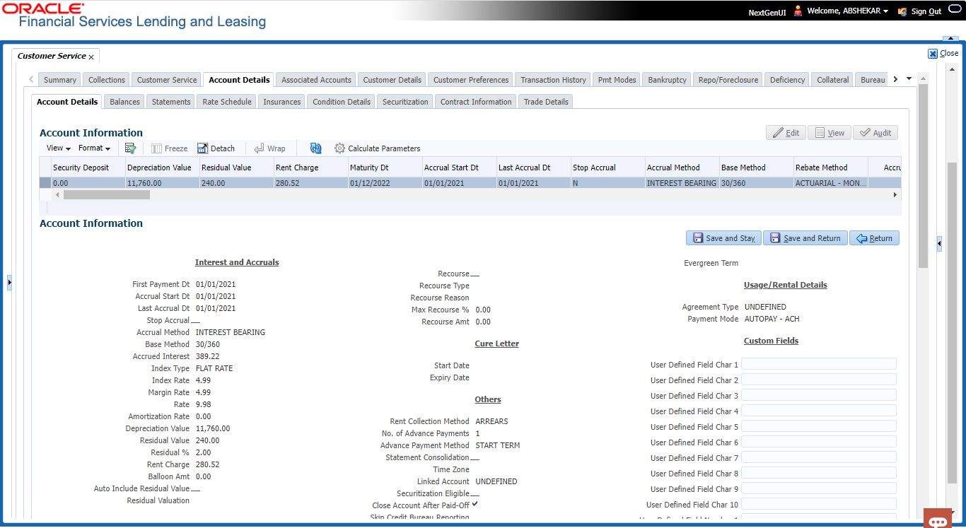

In the Account Information section click View.
Figure 4-17 Customer Service - Account Details
View the following information for Lease servicing product.
Table 4-40 Account Details
