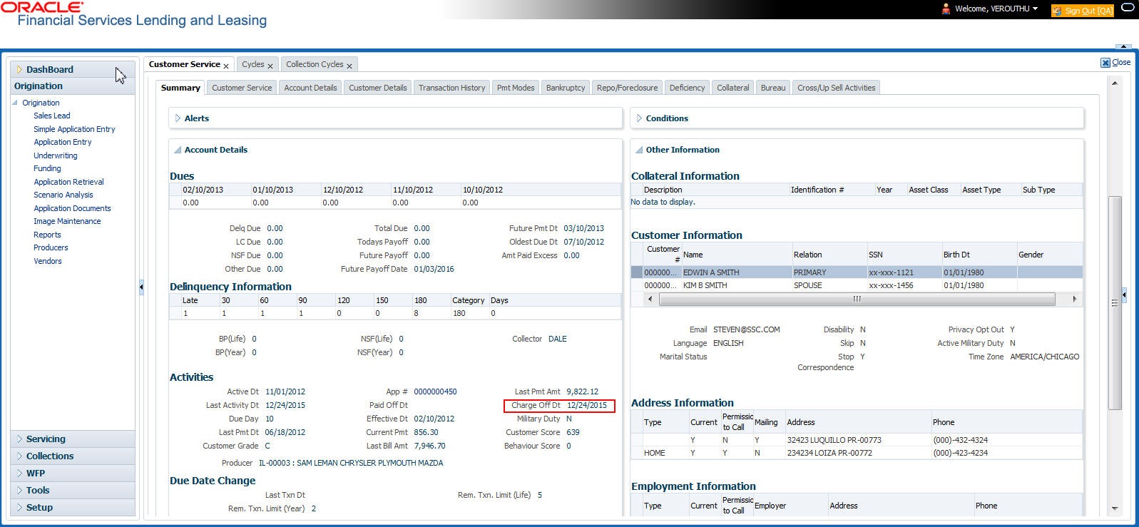

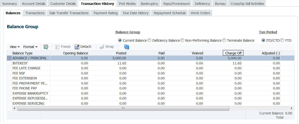

When you charge off account, the system changes the status to CHARGED OFF. The balance on the account appears on Customer Service form’s Balance screen when you choose Deficiency Balance in the Balance Group section.
The date of the charge off appears on Account Details screen in Activity section’s Chargeoff Dt field.
