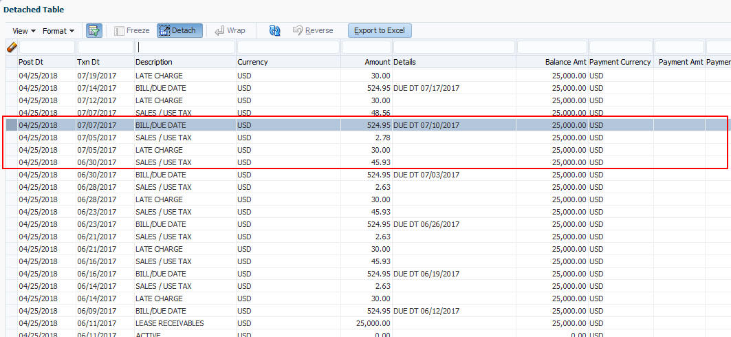

- Along with the above transaction, system automatically posts SALES / USE TAX linking transaction to determine and update the tax component separately.
- For accounts with tax exemption, sales tax will not be calculated and link transaction is not posted.
- In case of reversal, if the parent transaction is reversed then corresponding child SALES / USE TAX tax transaction will also be reversed.
- On successfully posting the transaction, the details are updated on to the customer account in Customer Service > Transaction History > Transactions tab.

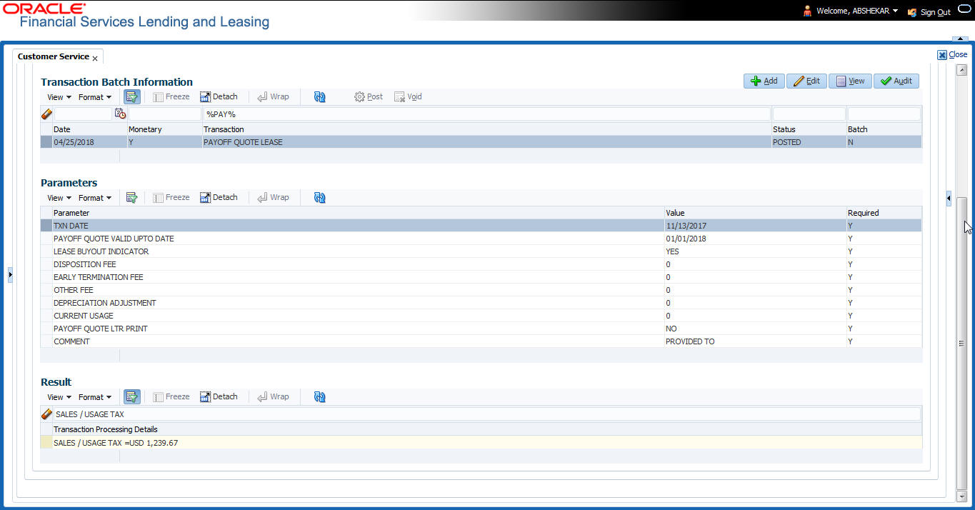

- For the calculation method defined in setup as Payoff Quote Lease, on posting this transaction system calculates the tax on unpaid Lease Receivables and displays the Sales / Usage Tax due bucket with the total of current outstanding and future dues.
