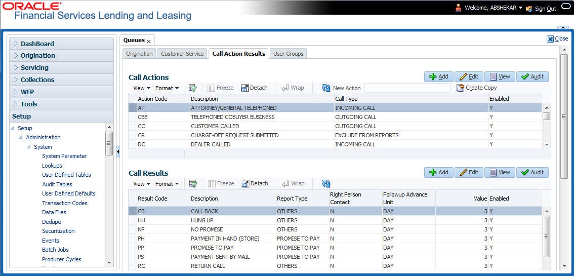

3.8.3 Call Action Results tab
- Click Setup > Setup > Administration > User > Queues > Call Action Results. The screen contains two sections:
- Call Actions
- Call Results
- In the Call Actions section, perform any of the Basic Operations mentioned in Navigation chapter.
You can either define new Call Action details or specify a new action code in the New Action field and click Create Copy to create a copy of selected call action with details.A brief description of the fields is given below:
Table 3-75 Call Action Results
Field Do this Action Code Specify the action type code. Description Specify the description for the call action type. Call Type Select the call type from the drop-down list. Enabled Check this box to enable the call action. - Perform any of the Basic Actions mentioned in Navigation chapter.
- In the Call Results section, you can define call action result codes and corresponding descriptions. Perform any of the Basic Operations mentioned in Navigation chapter.
Table 3-76 Call Results
Field Do this Result Code Specify the result type code for the specified call action type. Description Specify the description for the result type. Report Type Select the report type for the result type, from the drop-down list. Right Person Contact Check this box to indicate that result type is a right person contact. Follow-up Advance Unit Select the unit for advancing the follow-up date/time from the dropdown list. Value Specify the value for the follow-up advance unit. Enabled Check this box to enable the result. - Perform any of the Basic Actions mentioned in Navigation chapter.
