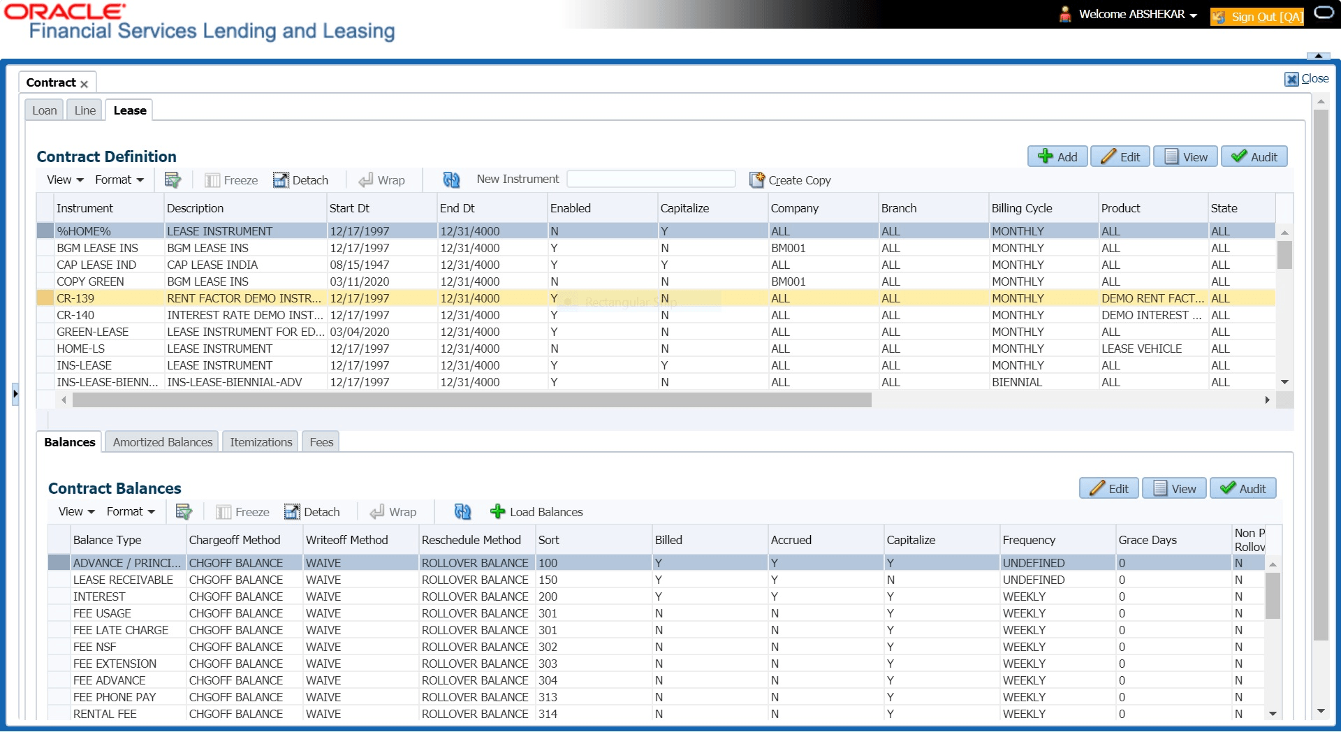

To set up the Contract
- On the Oracle Financial Services Lending and Leasing home screen, click Setup > Setup > Administration > Products > Contract > Lease.
- On the Contract Definition section, perform any of the Basic Operations mentioned in Navigation chapter.
A brief description of the fields is given below:
Table 4-17 Contract Definition
Field Do this Instruments section Instrument Specify the code identifying the instrument. Description Specify the description of the instrument being defined. Start Dt Specify the start date for the instrument. You can even select the date from the adjoining Calendar icon. End Dt Specify the end date for the instrument. You can even select the date from the adjoining Calendar icon. Enabled If you check this box, the system will consider this contract definition when selecting a instrument for an application.
