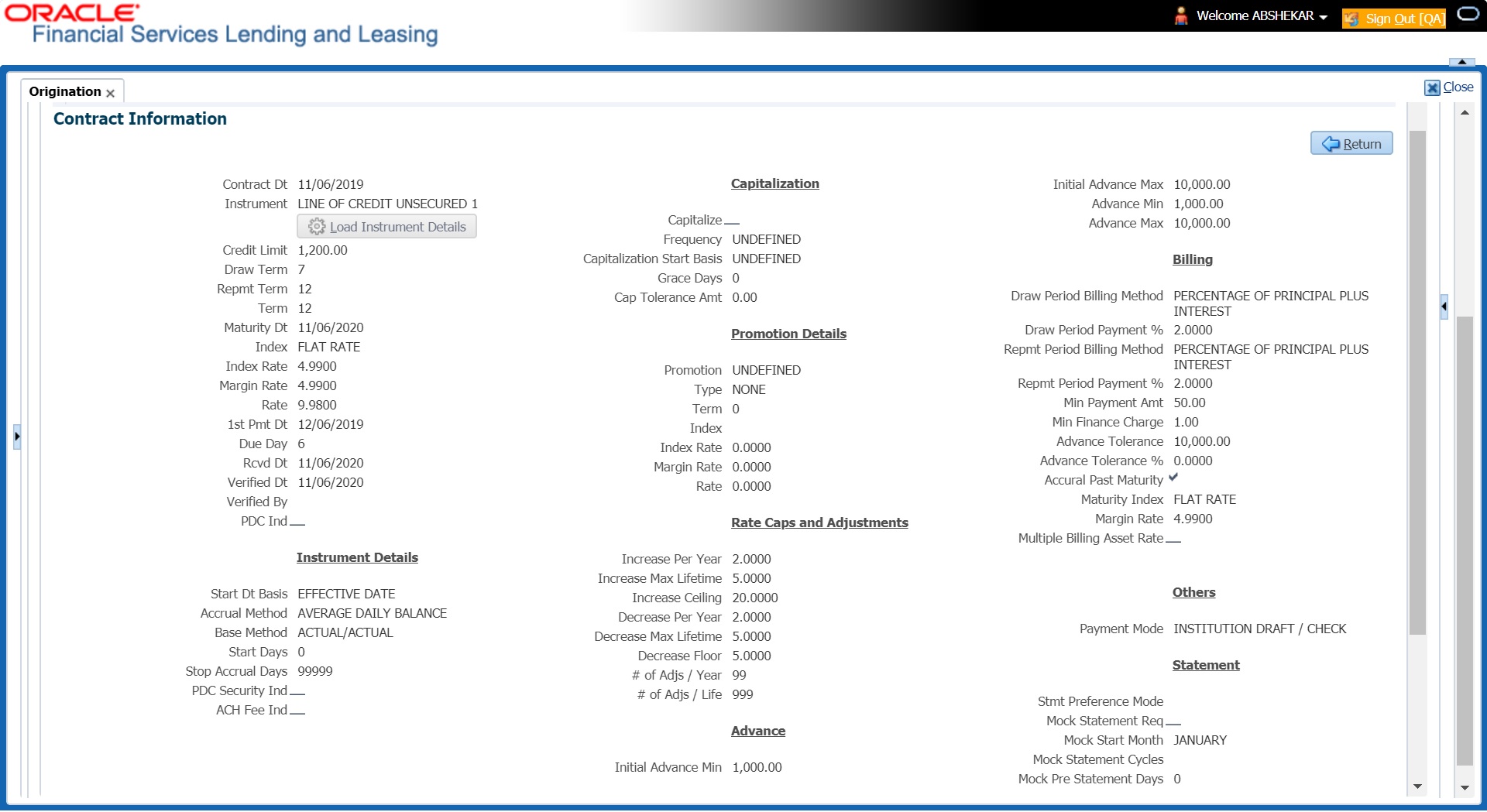

While working with the Contract tab for Line of credit applications, you can either enter the contract details manually or make use of the Suggest option which auto populates the contract details.
- System loads the details of 1st instrument available in Instrument drop-down list.
- Populates decision level contract parameters and Verified By field with User Code.
Since in one click all the required contract information is populated to fund the application, this option helps to improve operational efficiency. But however, this option is not available if the contact instrument is already loaded.
- Open the Funding screen and load the application you want to work with.
- On the Funding screen, click the Contract tab.
- If the application you opened is for a Islamic Line of credit, the Line of credit screen appears.
- Using the information in the contract packet, complete the Contract section.
(The system calculator may used when completing this section. For more information, see the Tools chapter.)
- In this section, you can perform any of the Basic Operations mentioned in Navigation chapter.
A brief description of the fields is given below:
Table 8-1 Contract
Field Do this Contract section Contract Dt Specify the contract date. Credit Limit Specify the credit limit. Draw Term Enter the draw term. This is the period of time during which you can receive advances. Repmt Term Enter the repayment term. This is the period of time during which you must pay the outstanding balance of your account, with accrued interest, but may not request further advances. The repayment period begins at the end of the draw period. Term Enter the term. Maturity Dt Enter the maturity date. Index Select the index. Index Rate View the index rate. Margin Rate Specify the margin rate. Rate View the interest rate. 1st Pmt Dt Specify the first payment date. Due Day Specify the due day. Rcvd Dt Enter the contract received date. Verified Dt Enter the contract verification date. Verified By View the user id who verified the contract. PDC Ind If selected, indicates that the customer has opted for PDC. Instrument Details – An instrument is a contract with specific rules tied to it. An instrument associated with the application indicates OFSLL of the type of contract being used for the approved loan. Items defined in the contract are locked in when you select the instrument from drop down list and click on Load Instrument Details. These values cannot be changed on the funding screen.
Any changes to the instrument in account will be handled by monetary/non-monetary transactions.
The system loads all the rules established by the company that are required at the time of funding; for example, the accrual method, billing method, type of billing, tolerance, due dates, extensions and so on.
Start Dt Basis View the accrual start basis. Accrual Method View the accrual calculation method. Base Method View the accrual base method. Start Days View the accrual start days. Stop Accrual Days View the accrual stop days. PDC Security Ind If selected, indicates that the customer has submitted the PDC as a security. ACH Fee Ind Indicates that the ACH fee should be applied or not. Depending on the status of check box, the ACH fee is applied based following conditions- When the check box is selected and the fee amount is ZERO, system will not apply the ACH fee.
- When the check box is selected and the fee amount is BLANK, system will apply the ACH fee from Contract setup.
- When the check box is selected and the fee amount is specified, system will apply the specified amount and overrides the ACH fee amount mentioned in Contract Setup.
- When the check box is not selected, system will apply the ACH fee amount mentioned in Contract Setup.
Capitalization section
This section displays the capitalization parameters pre-defined at Setup > Contract screen and allows you to modify only the Grace Days value for balance capitalization.
Capitalize If selected, indicates that the capitalization of balances is enabled while funding the application. Frequency View the capitalization frequency defined at Contract level.
After funding, all the account balances are capitalized to principal in the same frequency except for Balance Frequency where different frequency may be defined for each balance type.
Capitalization Start Basis View the capitalization start date as either Contract Date or First Payment Date on which capitalization next date is calculated. Grace Days View or Modify the grace days allowed in the frequency (minimum 0, maximum 31) before capitalizing the balances to account. This is also the deciding factor for executing the capitalization batch job which is based on Capitalization Frequency + Grace Days.
However, note that Grace Days are not accounted for Month End type of capitalization frequency and is ignored even if specified.
Cap Tolerance Amt View the capitalization tolerance amount which is the minimum amount to qualify for capitalization. Promotion Details – If applicable, enter information regarding any promotion associated with the application in the Promotion section Promotion Select the promotion. Type View the promotion type. Term View the term. Index View the promotion index (displays only). Index Rate View the promotion index rate (displays only). Margin Rate View the promotion margin rate (displays only). Rate View the promotion rate. Rate Caps & Adjustments section Increase Per Year View the maximum rate increase allowed in a year. Increase Max Lifetime View the maximum rate increase allowed in the life of the Line of credit. Increase Ceiling View the rate cap (maximum). Decrease Per Year View the maximum rate decrease allowed in a year. Decrease Max Lifetime View the maximum rate decrease allowed in the life of the Line of credit. Decrease Floor View the rate decrease allowed. # of Adjs / Year View the maximum number rate changes allowed in a year. # of Adjs / Life View the maximum number of rate changes allowed in the life of the Line of credit. Initial Advance Min Amt View the minimum initial advance amount. Initial Advance Max Amt View the maximum initial advance amount. Advance Min View the minimum subsequent advance amount. Advance Max View the maximum subsequent advance amount. Billing section Draw Pre Bill Days This is the number of days before the first payment is due that accounts funded with this Loan instrument will be billed for the first payment. Thereafter, the accounts will be billed on the same day every month.
If an account has a first payment date of 10/25/2003 and Pre Bill Days is 21, then first payment due will be on 10/04/2003, and then 4th of every month.
Draw Period Payment % View the percentage of draw period payment allowed. Repmt Period Billing Method View the repayment period billing method allowed. Repmt Period Payment % View the percentage of repayment period payment allowed. Min Payment Amt View the minimum payment amount. Min Finance Charge View the minimum finance charge. Advance Tolerance View the advance tolerance amount. Advance Tolerance % View the advance tolerance percentage. Accural Past Maturity View the accural past maturity. Maturity Index View the maturity index rate. Margin Rate View the margin rate. Multiple Billing Asset Rate Check this box to indicate if multiple asset rates are applicable for one billing period.
System considers billing period from current due date to the next due date. Multiple rates are fetched only when rate end date (rate start date + rate frequency) ends one or more cycle(s) before the next due date i.e. current rate record does not cover the entire billing period.
Others Payment Mode Select the type of repayment mode to indicate if it is Autopay/ Direct Debit or not using any of the following option from the drop-down list. The list is populated from REPAYMENT_PMT_ MODE_CD lookup code.- INSTITUTION DRAFT / CHECK (default)
- AUTOPAY (ACH)
- AUTOPAY (CREDIT CARD)
- AUTOPAY (DEBIT CARD)
- POST DATED CHECKS
For an AUTO PAY type of Payment Mode, ensure that at least one active ACH record exist and for CHECK type of Payment Mode, there are NO active ACH records.
Statement section
This section allows to define the preferences for Mock Statement generation at Master Account level. Generating a Mock Statement helps to mock the asset billing process with a future date and to get an upfront statement indicating future dues of Master and Associated Accounts. In Vacation Ownership industry, such statements are required to forecast future dues based on current Timeshare holdings.
The default populated preference here are propagated from Setup > Administration > Products > Contract screen when the instrument is loaded.
Note: These fields are enabled only for Master Account, i.e. only if the Master Account check box is selected in Origination > Master Account tab. If the option is unchecked even at a later point, system refreshes these fields making them as Read-Only.
Stmt Preference Mode Select the account statement preference mode as either Email or PHYSICAL from the drop-down list. Mock Statement Req Select this check box to indicate if the account is to be included in Mock statement Generation.
Note: Based on this selection, others fields related to Mock Statement below are enabled and becomes mandatory for providing details.
Mock Start Month Select the start month of Mock Statements period from the drop-down list. Mock Statement Cycles Select the total number of billings (between 1-12) that are to be generated post Mock Statement Start Date. Mock Pre Statement Days Specify the number of Pre bill days for Mock Statements generation. Agreement Details Agreement Number Specify the agreement number which is to be associated to the application.
Note: On funding, this agreement number is also associated to the account and in-turn helps to group all those accounts with a particular agreement number.
