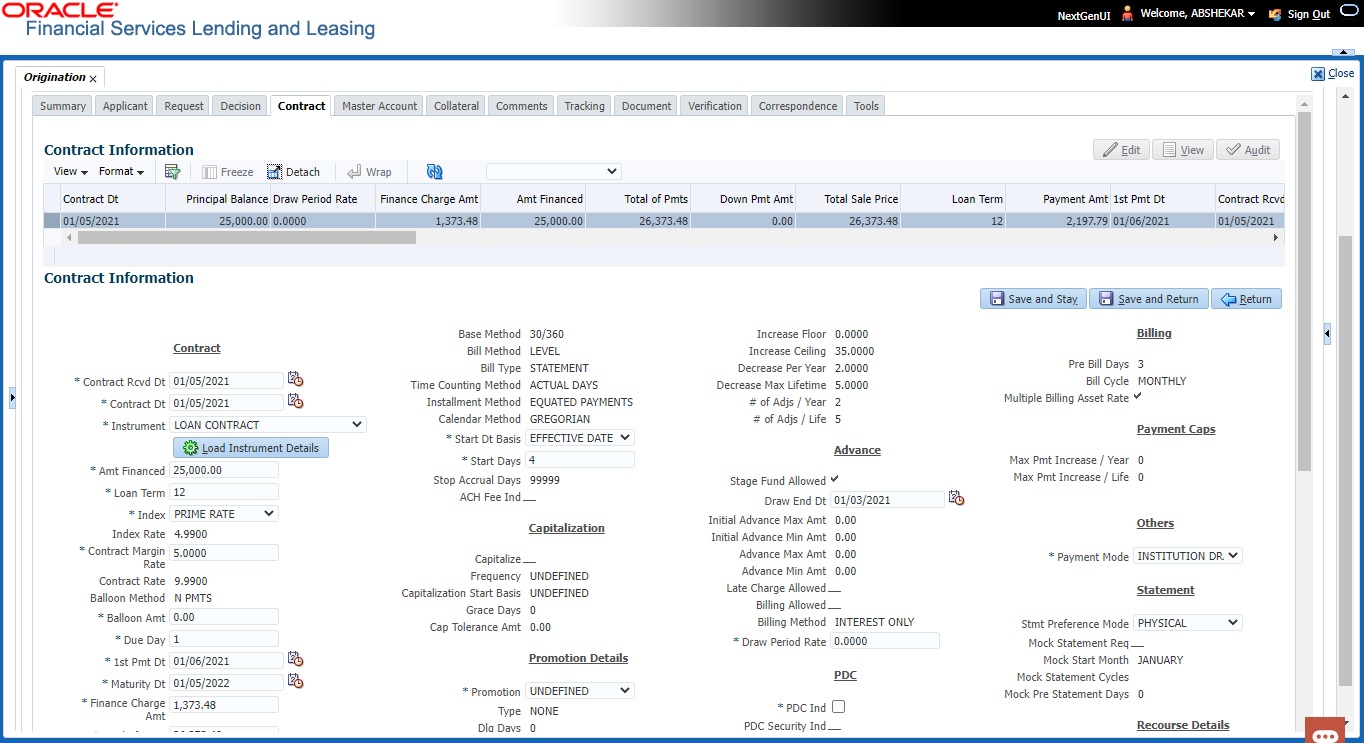

The screens associated with the Contract link are the core of the funding process. They allow you to perform the important task of completing the truth-in-lending details. These screens include information mandated by Regulation Z; information about the financed amount, the payment schedule, the total of these payments, the finance charge, the resulting annual percentage rate (calculated according to Federal/Central bank guidelines; that is, within 125% of the Treasury OCC calculated APR) for the conventional Loan, and internal rate of return for Islamic Loan. Use the Loan packet to supply the required information.
In completing the truth-in-lending details on the Contract link, you will enter Loan information. The truth-in-lending details must be completed before a Loan can be funded.

A brief description of the fields is given below:
Table 8-1 Contract
Field Do this Contract section Contract Rcvd Dt Specify the contract received date. Contract Dt Specify the contract date. Instrument Select the required instrument from the drop down list and click on Load Instrument Details. Amt Financed Specify the amount financed: the Loan amount applied minus the prepaid finance charges. Prepaid finance charges can be found on the Good Faith Estimate/Settlement (HUD-1 or 1A). For example, if the borrower’s note is for $100,000 and the prepaid finance charge total is $5,000, the amount financed would be $95,000. The amount financed is the figure on which the annual percentage rate (APR) is based. Loan Term Specify the term/number of payments. Index Select the index. Index Rate View the index rate. Contract Margin Rate Specify the margin rate. Contract Rate View the interest rate. The following 3 fields - Regulatory Name, Regulatory Rate, and Contract Imputed Rate are displayed only if the Imputed Interest check box is selected in Contract Setup (i.e. Setup > Administration > Products > Contract screen).

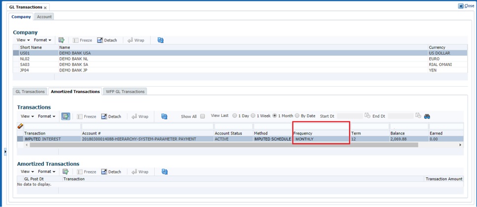

Figure 8-11 Interfaces-GL Transactions-Imputed Amortization
- Opening balance is updated with total imputed interest amount which is calculated as part of Imputed Interest amortization schedule.
- Transaction = IMPUTED INTEREST, Method = IMPUTED SCHEDULE, and Frequency same as account billing frequency.
