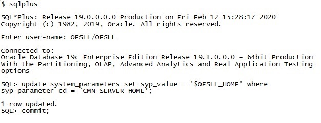

Setting the CMN_SERVER_HOME parameter values
As mentioned, the CMN_SERVER_HOME parameters must be set manually before the application screens can be used to set other parameters.
CMN_SERVER_HOME
Set it to the $OFSLL_HOME directory.
Setting the remaining system parameters manually or from the setup screen
Figure 1-17 Command prompt window 17
