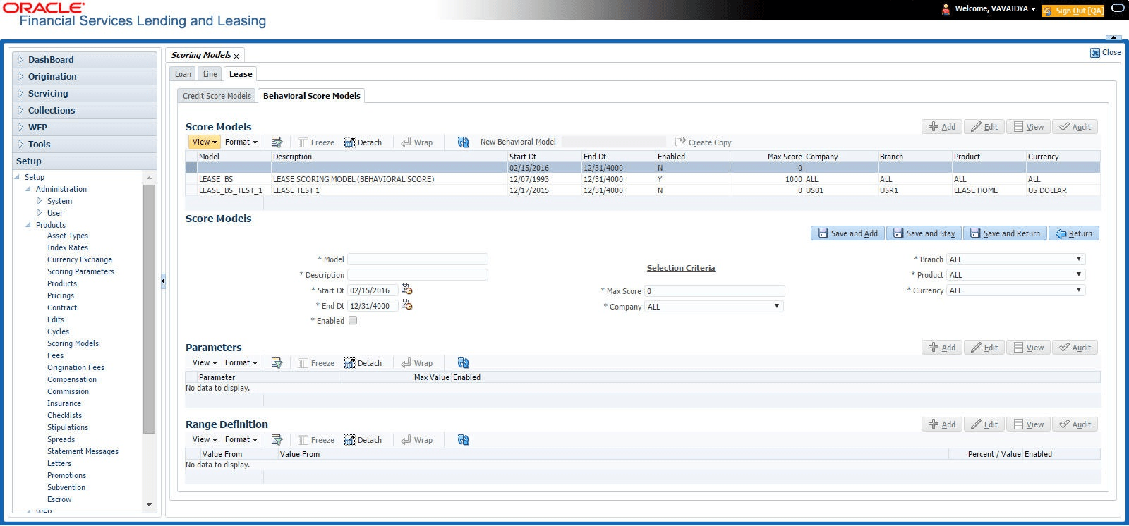

4.5.1 Behavioral Score Models
You can either define new Behavioral Score Model details or specify a new name in the New Behavioral Model field and click Create Copy to create a copy of selected score model with details.
  1. Click Setup > Setup > Administration > User > Products > Scoring Models > Lease > Behavioral Score Models.
  2. In the Score Models section, perform any of the Basic Operations mentioned in Navigation chapter.
    Figure 4-5 Behavioral Score Models
    Behavioral Score Models - Lease
    A brief description of the fields is given below:
    Table 4-21 Behavioral Score Models

  3. Perform any of the Basic Actions mentioned in Navigation chapter.
  4. Click Create Copy button on the Score Models screen to create copy of the selected record with details.
