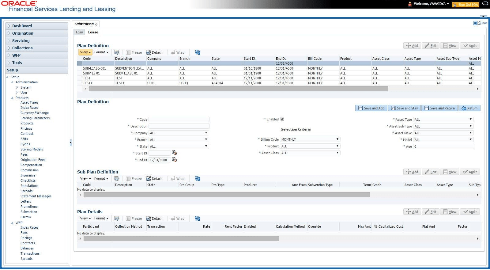

4.11.1 Lease Subvention Plans
The Lease Subvention Plans screen allows you to set up subventions for Leases.
To set up the Lease Subvention Plans screen.
  1. On the Oracle Financial Services Lending and Leasing home screen, Click Setup > Setup > Products > Subvention > Lease.
  2. The system displays the Lease Subvention screen. The details are grouped into three.
    • Plan Definition
    • Sub Plan Definition
    • Plan Details.
  3. In the Plan Definition section, perform any of the Basic Operations mentioned in Navigation chapter.
    A brief description of the fields is given below:
    Table 4-37 Plan Definition

  4. Perform any of the Basic Actions mentioned in Navigation chapter.
  5. In the Sub Plan Definition section, perform any of the Basic Operations mentioned in Navigation chapter.

  6. Perform any of the Basic Actions mentioned in Navigation chapter.
  7. In the Plan Details section, perform any of the Basic Operations mentioned in Navigation chapter.
