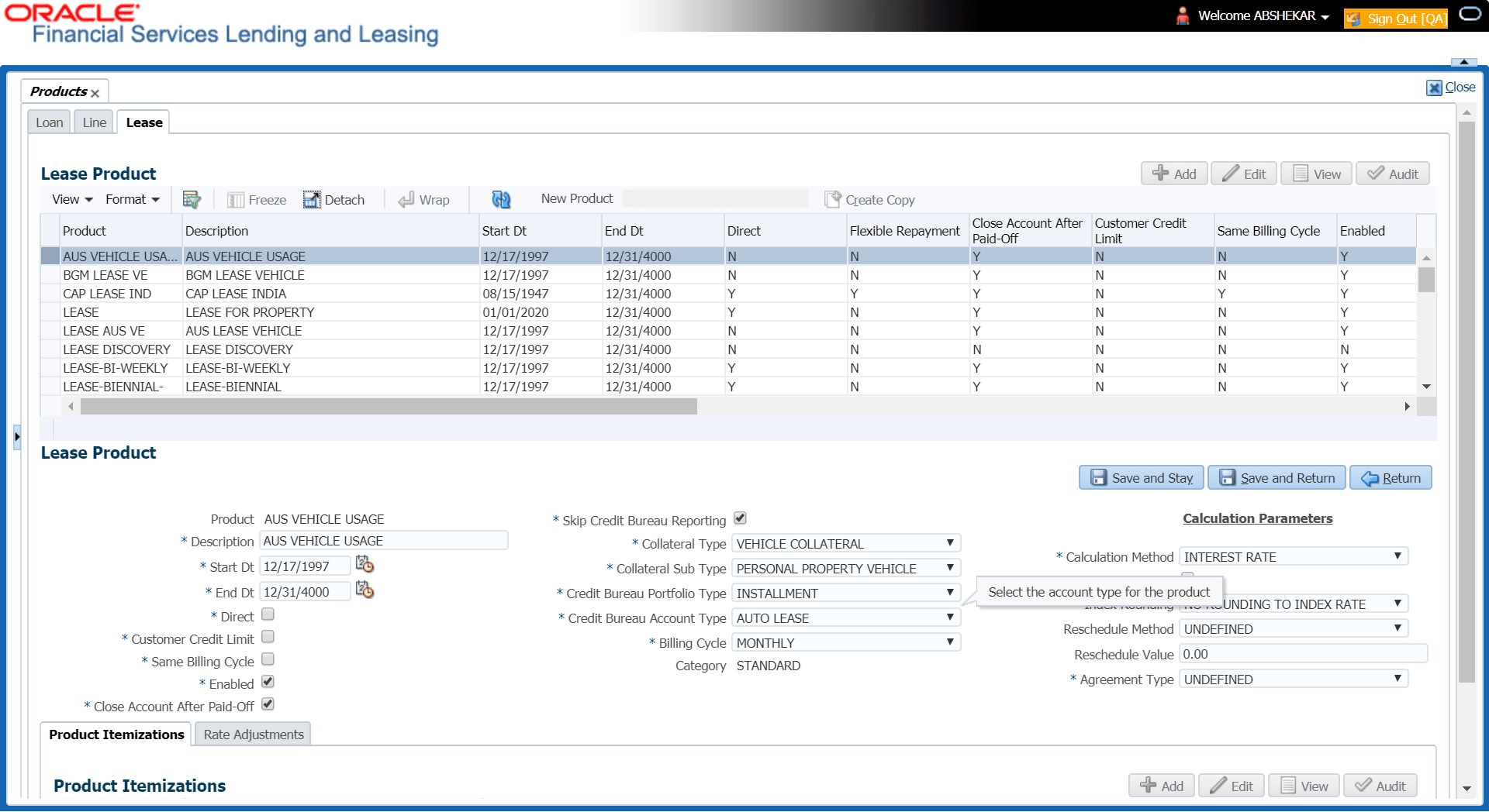

To set up the Product
You can either define new Product details or specify a new product code in the New Product field and click Create Copy to create a copy of selected product with details.
  1. On the Oracle Financial Services Lending and Leasing home screen, Setup > Setup > Administration > User > Products > Products > Lease.
  2. In the Product Definition section, perform any of the Basic Operations mentioned in Navigation chapter.
    A brief description of the fields is given below:
    Table 4-11 Product Definition
    Field Do this
    Product Specify the product code as defined by your organization (in other words, how you want to differentiate the products). For example, products can be differentiated according to asset. The product code, or name, is unique.
    Description Specify the description of the product. (This is the product description as it appears throughout the system).
    Start Dt Specify the start date for the product. You can even select the date from the adjoining Calendar icon.
    End Dt Specify the end date for the product. You can even select the date from the adjoining Calendar icon.
    Direct Check this box, if you need the product to be originated directly to customer. (In this case, the compliance state is the state listed in the customer’s current mailing address.) If unchecked, the product is an indirect lending product; that is, payment is made to the producer. (In this case, the compliance state is the state listed in the producer’s address.)

    Billing Cycle
    Select the billing cycle for the product, from the drop-down list.
    Note: This field is not editable and the billing cycle is selected as MONTHLY by default if the lease calculation method is selected as RENT FACTOR.
    Category By default the category of the product is selected as STANDARD and is not editable.
    Calculation Parameters: This section allows you to define the parameters for lease calculation starting from choosing the calculation method.
    Calculation Method
    Select the type of lease calculation method as one of the following:
    • RENT FACTOR (selected by default)
    • INTEREST RATE
    If the lease calculation method is selected as Interest Rate, the following fields are enabled in the screen and also the Rate Adjustments sub tab is available to specify the details:
