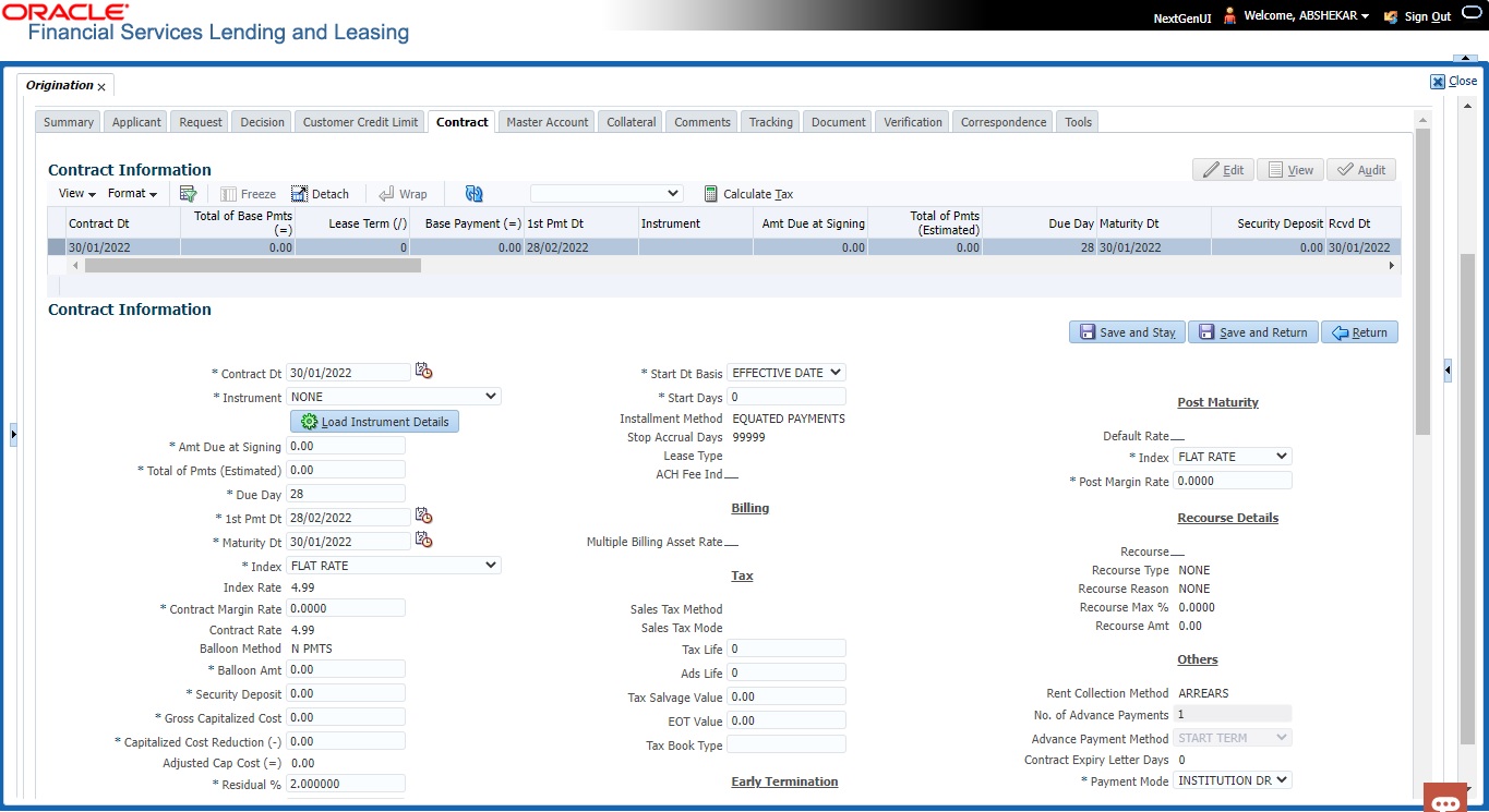

You can use the quick calculator provided with the drop-down list adjacent to the ‘Calculate’ button to calculate the required Lease parameters. You can also use the calculator available in Tools section for completing this step. For detailed information on using the Calculator tools, refer Tools chapter in the document.
While working with the Contract tab for Lease applications, you can either enter the contract details manually or make use of the Suggest option which auto populates the contract and payment details.
- System loads the details of 1st instrument available in Instrument drop-down list.
- Updates the contract date as current GL post date using which all the payment calculations are done.
- Populates decision level contract parameters and Verified By field with User Code.
- Calculates the payment amount and Sales Tax (if the COMPANY parameter XSL_TAX_INTERFACE is INTERNAL). However, the Suggest option is not available for external interface (VERTEX) since the calculation is handled outside the system.
Since in one click all the required contract information is populated to fund the application, this option helps to improve operational efficiency. But however, this option is not available for Rental based lease applications and if the contact instrument is already loaded.

Field Do this Contract section Contract Dt Specify the contract date. Instrument Select the required instrument from the drop down list and click on Load Instrument Details. Amt Due at Signing Enter the prepaid amount. Total of Pmts (Estimated) Enter the estimated total of payments. Due Day Specify the due day. 1st Pmt Dt Specify the first payment date. Maturity Dt Specify the maturity date. Index Select the applicable index type from drop-down list.
Note: If the lease calculation method is selected as Rent Factor, then Flat Rate Index type is applicable by default.
Index Rate Specify the approved index rate. Contract Margin Rate Specify the contract margin rate. Contract Rate Specify the contract rate. Balloon Method View the balloon payment method.
Note: This field is displayed only if the lease calculation method is Interest Rate.
Balloon Amt Specify the balloon amount.
Security Deposit Specify the security deposit amount. Gross Capitalized Cost Enter the gross capitalized cost. Capitalized Cost Reduction (-) Enter the cap cost reduction. Adjusted Cap Cost (=) Enter the adjusted cap cost. Residual % View the residual percentage. Residual Value (-) Enter the residual value. Depreciation Value (=) Specify the depreciation value. Rent Charge (+) Enter the rent. Rent Factor View the rent factor.
Note: This field is applicable only if the lease calculation method is selected as Rent Factor.
Total of Base Pmts (=) Enter the total of payments. Lease Term (/) Enter the term. Base Payment (=) Enter the payment amount. Estimated Sales Tax (+) Enter the sales tax amount. Sales Tax View the sales tax percentage. Estimated Pmt (=) Enter the payment amount percentage. Rcvd Dt Specify the date on which deposit is received. Verified Dt Specify the contract verification date. Verified By View the user id who verified the contract. Depreciation section
