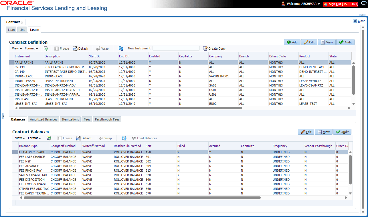

To set up the Contract
You can either define new Contract Definition details or specify a new name in the New Instrument field and click Create Copy to create a copy of selected contract with details.
  1. On the Oracle Financial Services Lending and Leasing home screen, click Setup > Setup > Administration > Products > Contract > Lease.
  2. On the Contract Definition section, perform any of the Basic Operations mentioned in Navigation chapter.
    A brief description of the fields is given below:
    Table 4-17 Contract Definition
    Field Do this
