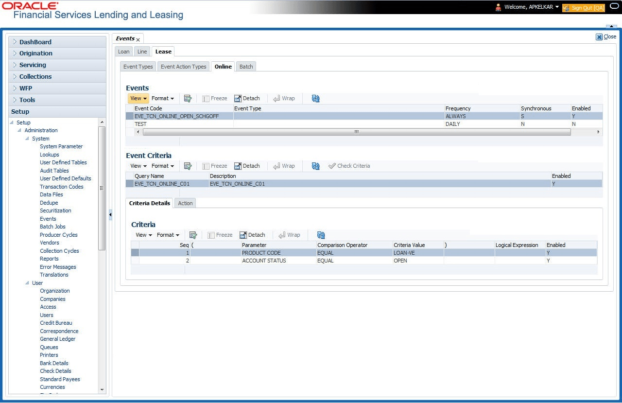

To view Online Event
Click Setup > Setup > Administration > System > Events >Lease > Online.
A brief description of the fields is given below:
Table 2-37 Online Event
| Field | Do this |
| Event Code | View the event code. |
| Event Type | View the event type. |
| Synchronous | S indicates that the event is synchronous (i.e. any failure in triggering the event will fail to trigger the entire transaction). If A indicates that the event is asynchronous (i.e. any failure in the event will not affect the transaction, which will be successfully completed). |
| Enabled | Y indicates event type is enabled and N indicates disabled. |
The Event Criteria section allows you to view the query defined for an event.
Table 2-38 Event Criteria
| Field | Do this |
| Query Name | View the query name. |
| Description | View the query description. |
| Enabled | Y indicates event criteria is enabled and N indicates disabled. |
Criteria Details
The Criteria Details sub tab allows you to view the defined selection criteria for the event. System uses these criteria to determine which account to include in the event action.
Although system allows to define customized selection criteria, the execution of additional selection criteria requires additional processing at server level and can have significant performance impact delaying the EOD processing/web services. Hence it is recommended to have careful consideration while defining the additional selection criteria (like using user-defined tables and columns) and/or get approval from your database administrator before using any selection criteria.
Table 2-39 Criteria Details
| Field | Do this |
| Seq | View sequence number. |
| ( | Indicates opening bracket. |
| Parameter | View the parameter selected for the criteria. |
| Comparison Operator | View the comparison operator selected for the criteria. |
| Criteria Value | View the criteria value. |
| ) | Indicates closing bracket. |
| Logical Expression | View the logical operator selected for the criteria. |
| Enabled | Y indicates event selection criteria is enabled and N indicates disabled. |
Actions
In the Actions sub tab, you can view the actions that the system performs when event is triggered. There can be more than one event action for a particular event and the Seq field defines the order in which the event action should occur.
Table 2-40 Actions
| Field | Do this |
| Description | View the event action description. |
| Seq | View sequence number defined for the action. |
| Enabled | Y indicates event action is enabled and N indicates disabled. |
For each event action, view the Action Parameters defined. A brief description of the fields is given below:
Table 2-41 Action Parameters
| Field | Do this |
| Description | View the parameter description. |
| Value | View the parameter value. |
| Required | Y indicates action parameter is required and N indicates not-required |
