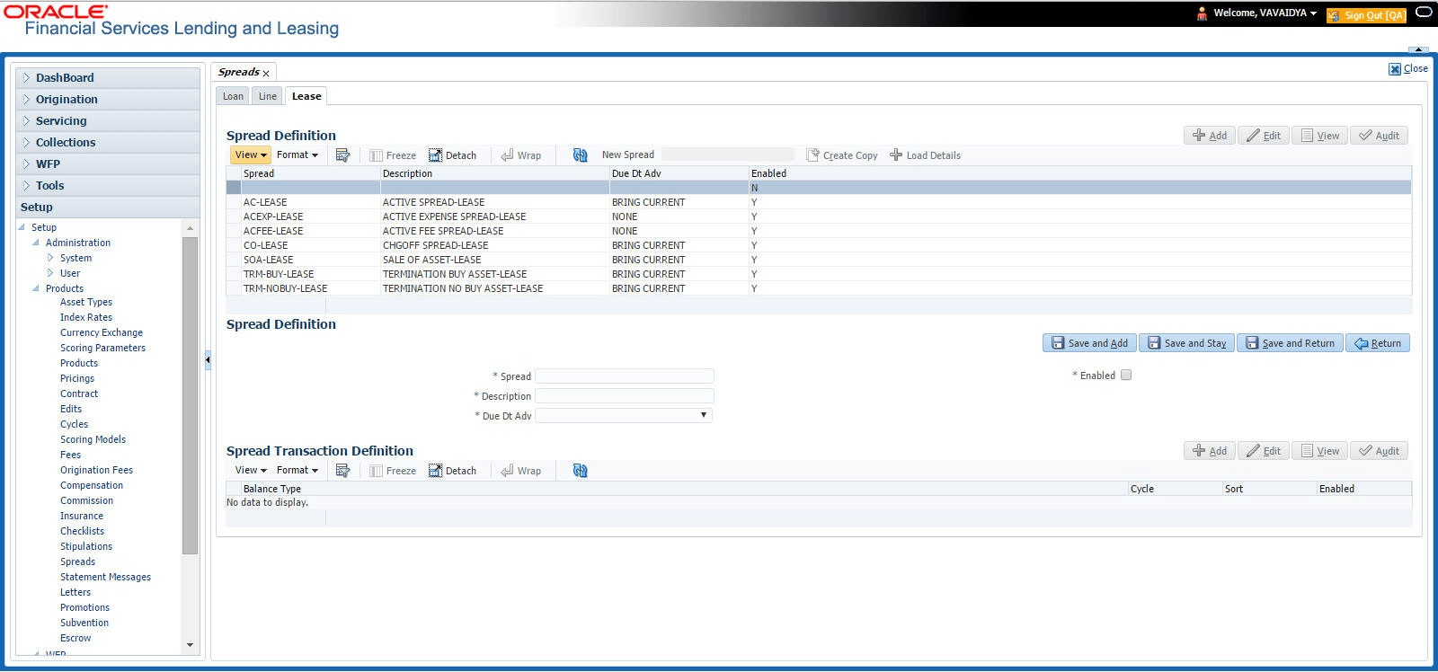

You can either define new Spread Definition details or specify a new name in the New Spread field and click Create Copy to create a copy of selected spread definition with details.
  1. On the Oracle Financial Services Lending and Leasing home screen, click Setup > Setup > Products > Spreads > Lease > Spread Definition.
    In the Spread Definition section, perform any of the Basic Operations mentioned in Navigation chapter.

    Enabled Check this box to enable the spread.
  2. Perform any of the Basic Actions mentioned in Navigation chapter.
  3. In the Spread Transaction Definition section, perform any of the Basic Operations mentioned in Navigation chapter.

To Load Details
  1. Create a record in Spread Definition section, with Enabled check box unchecked.
  2. Click Load Details button, the system will load the spread transaction definition details.
