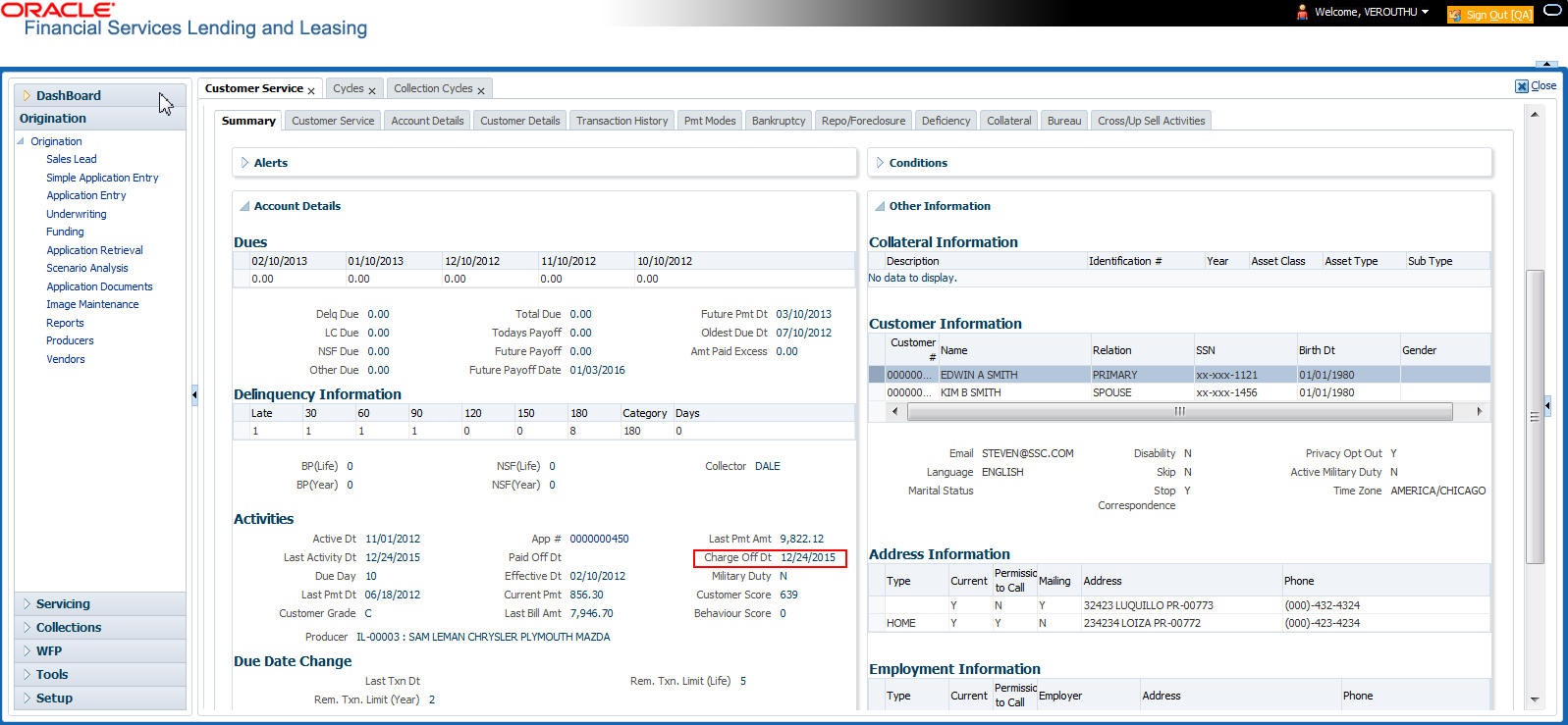

The date of the charge off appears on Account Details screen in Activity section’s Chargeoff Dt field.
