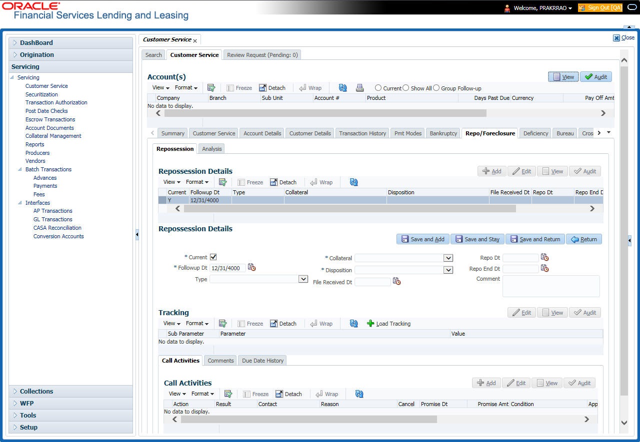

- Open the Customer Service screen and load the account you want to work with.
- Click the Repo/Foreclosure sub tab, then click Foreclosure.
- In the Foreclosure Details section, select the foreclosure record you want to work with.
-or-
- Click Add to refresh the Foreclosure screen to create a new record.
Figure 4-44 Repossession/Foreclosure Details - Add
- In the Foreclosure Details section, enter view or edit the following information:
Table 4-89 Foreclosure Details
In this field Do this Current box Select to indicate this is the current repossession/foreclosure record. Follow-up Dt Select the follow-up date for the repossession/foreclosure. Disposition Select the foreclosure disposition. Type Select the foreclosure type. Collateral Select the foreclosure asset. File Received Dt Enter the file received date for the foreclosure. Foreclosure Start Dt Enter the foreclosure start date. Foreclosure End Dt Enter the foreclosure end date. Comment Enter a comment. - In the Tracking section, click Load Tracking. The system loads the foreclosure tracking parameters.
- If you want to reduce the list of parameters, select a sub attribute in the Sub Attribute box. If your system has been configured to use the Sub Attribute field, only attributes in a particular group appear in the parameter display.
- Complete the Tracking section by entering information regarding foreclosure in the Value field for each corresponding Parameter, then click Save.
