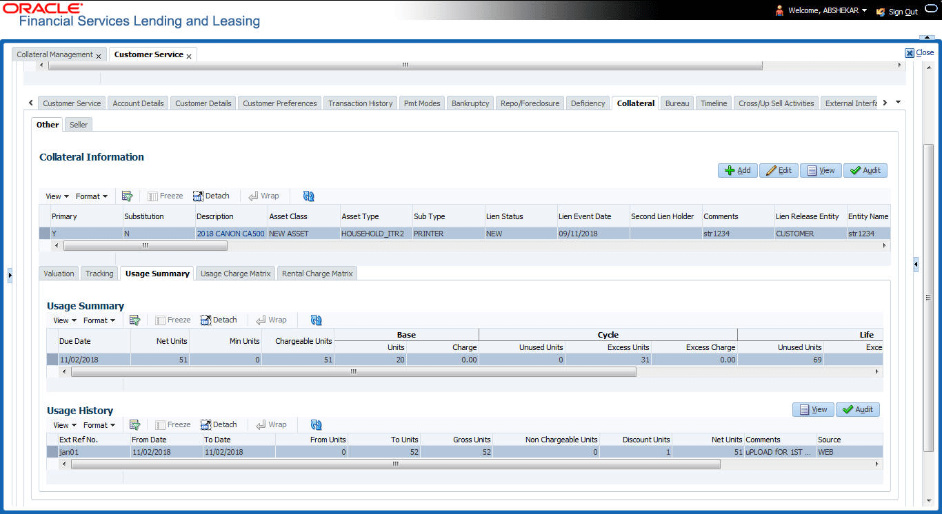

4.15.5 Usage Summary
The Usage Summary sub tab is displayed only if you have opened a Usage/Rental based lease account and gives you a summary of units charged for asset Usage/Rental which is derived based Usage/Rental Charge Matrix.
The incoming data of asset usage details are classified into the chargeable buckets of Base, Cycle, and Life and based on the defined amount, the total units are charged. Here each record indicates chargeable units for each billing cycle.
However the calculated chargeable units are only displayed and usage fee is posted on the account only after executing the batch job TXNUSG_BJ_100_01 (USAGE CHARGE PROCESSING) in SET-TPE job set.
For more information on how OFSLL handles Usage based leasing, refer to Appendix : Usage Based Leasing chapter and for Rental based leasing, refer to Rental Agreement section in Lease Origination User Guide.
Table 4-100 Usage Summary
In this field | View this |
Due Date | View the billing due date of the account which indicates when the usage units would be charged. |
Net Units | View the total consumed units for the current cycle. |
Min Units | View the minimum chargeable units for the current cycle. |
Chargeable Units | View the total chargeable units (if Net units consumed is less than Min units as per current cycle, Min units are charged). |
Base | |
Units | View the chargeable base units. |
Charge | View the amount to be charged on base units. |
Cycle | |
Unused Units | View the unused units for the current cycle. |
Excess Units | View the excess units for the current cycle. |
Excess Charge | View the amount to be charged as part of current cycle |
Life | |
Unused Units | View the unused units for the total lease term. |
Excess Units | View the excess units for the total lease term. |
Excess Charge | View the amount to be charged as part of the total lease term. |
Charge - Total Usage | View the amount to be charged as part of total lease term. |
Elastic Usage Term | View the system predicted term remaining to reach the asset usage life which is calculated either by Actual or Average method as per current usage pattern. |
