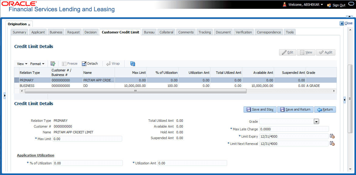

- Open Underwriting screen and load the underwriting application you want to work with.
- Click Customer Credit Limit tab.
- Perform any of the Basic Operations mentioned in Navigation chapter. A brief description of the fields are given below:
Table 7-35 Credit Limit Details
Field Do this Relation Type View the relationship type. This field is pre-populated with details from Applicant tab. Customer # / Business # This field is displayed blank for new customer/business and for an existing customer/business, the details are populated from Servicing > Customer Service > Customer details. Name View the customer name. This field is pre-populated with details from Applicant tab. Max Limit Specify the value of maximum credit limit amount that can be provided to the customer.
For new customer/business, the amount is pre-populated based on selected pricing in Decision tab for new applicant/ business. However, you can override the amount by entering the required value.
Total Utilized Amt View the total credit limit amount utilized for previously funded applications. Available Amt View the available credit limit amount on the account which is the difference of Max Limit - (Hold + Total Utilized + Suspended) amount. Hold Amt View the credit limit amount on hold which is based on the Hold transaction posted in servicing. Suspended Amt View the credit limit amount suspended which is based on suspended transaction posted in servicing. Grade Select the required grade from the drop-down list. There is no validation performed on the selected grade and can be selected based on customer credit worthiness. Max Late Charge Specify the maximum late charge amount. Limit Expiry Select the credit limit expiry date from the adjoining calendar. The expiry date is validated if application is being funded based on customer credit limit. Limit Next Renewal Select the date on which the credit limit has to be renewed from the adjoining calendar. Application Utilization section - This section allows you to define the portion (either percentage or amount) of credit limit utilization against the financed amount.
For example,
if the amount financed it 10,000 $ and percentage of Utilization for Primary is 80% then Utilized amount should be 10,000*0.8 = 8000 $.
Similarly, if the percentage of Utilization for Spouse is 20% the Utilized amount should be 10,000*0.2 = 2000 $.
Note: On specifying either percentage or amount of utilization, the other field is auto calculated based on financed amount.
% of Utilization Specify the percentage of credit limit utilization allowed against each applicant (Customer and business) added to the application. Utilization Amt Specify the amount of credit limit utilization allowed against each applicant (Customer and business) added to the application. - Perform any of the Basic Actions mentioned in Navigation chapter.
