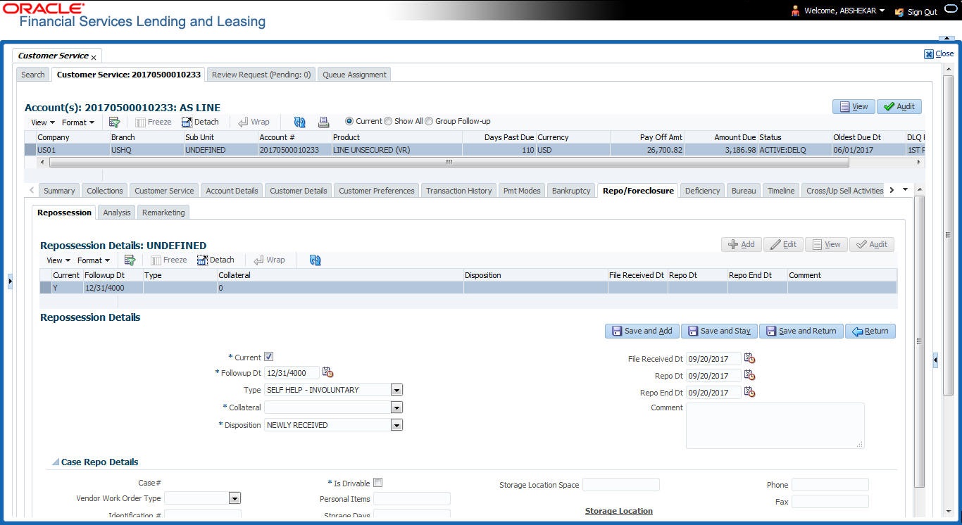

- Open the Customer Service screen and load the account you want to work with.
- Click the Repo/Foreclosure sub tab, then click Repossession.
- In the Repossession Details section, select the repossession record you want to work with.
-or-
- Click Add to refresh the Repossession screen to create a new record.
Figure 4-42 Repo Foreclosure - Repossession
- In the Details section, add view or edit the following information:
Table 4-87 Repossession
In this field Do this Current Select the check box to indicate if this is the current repossession record. Follow-up Dt Specify the follow-up date for the repossession from the adjoining calendar. Type Select the repossession type. Collateral Select the collateral involved in the repossession. Disposition Select the repossession disposition. File Received Dt Select the file received date for the repossession. Repo Dt Select the repossession start date. Repo End Dt Select the repossession end date. Comment Specify a comment. Case Repo Details - This section displays the following details based on the case response received from the interfaced third party system. Case # Displays the case number of the repossession. National Forwarder If checked, indicates that National Forwarder carrier is equipped in the repossession. Condition Report Status If checked, indicates that the condition report exist. Condition Report Recd Dt Displays the date when condition report was received. Mileage Displays the mileage of the vehicle. Key Status Indicates if the vehicle key(s) is available. Field Agent Name Displays the name of the field agent involved in the repossession. Address Displays the address of the field agent. Phone Displays the contact number of the field agent. Storage Location Displays the location where the vehicle is currently stored. Repo Location Displays the repossession location Police Dept Name Displays the name of police department involved in repossession. - In the Tracking section, click Load Tracking. The system loads the repossession tracking parameters.
