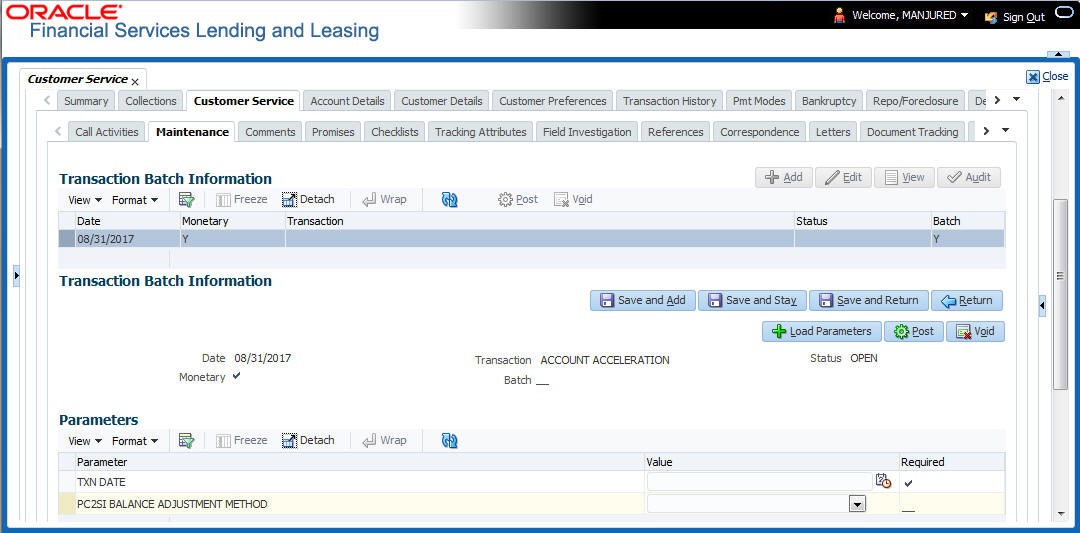

You can accelerate only those accounts which are in ACTIVE status and post the transaction either manually in the Customer Service > Maintenance screen or through Web Service (generic post transaction service).

ACCOUNT ACCELERATION | TXN DATE |
Select the date from which the acceleration is effective on the account. The same can either be the current date or a back date (up to contract date or account back date whichever is higher) but not a future date. The selected date will be the acceleration start date and the new maturity date of the account. In case of pre-compute loan accounts, the same date is used for the following actions:
PC2SI BALANCE ADJUSTMENT METHOD |
For 'Pre-Compute' accounts, select one of the following parameter from the drop-down list. The values in this list are populated based on the lookup code ‘PC2SI_BAL_METHOD_CD (PC2SI BALANCE ADJUSTMENT METHOD CODES)’
For details on how the PC to SI conversion calculation is done based on above selection, refer to Appendix - Account Acceleration chapter. For Non-Pre-Compute accounts, select the parameter value as Undefined. Else, system displays an error on selecting any other value as Balance Adjustment Method mandatory for Pre-Compute a/c. |
