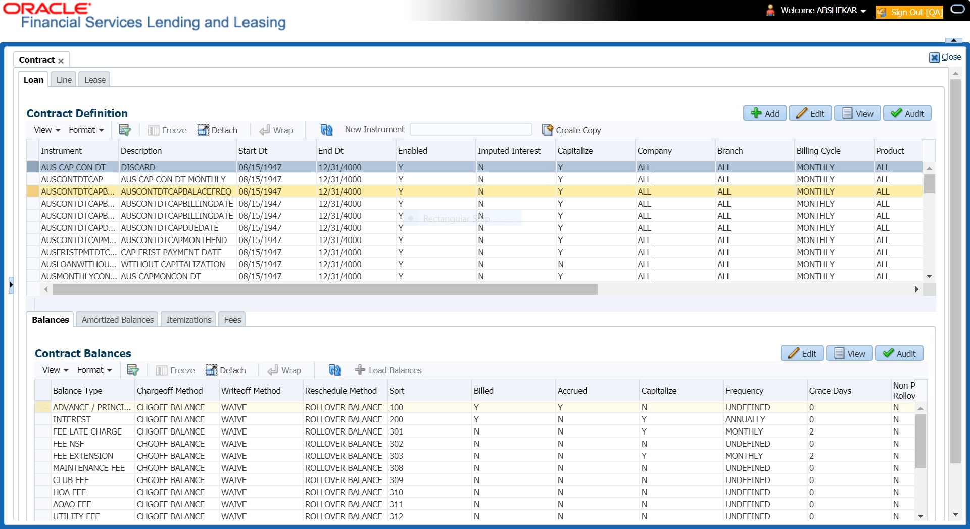

To set up the Contract
You can either define new Contract Definition details or specify a new name in the New Instrument field and click Create Copy to create a copy of selected contract with details.
  1. On the Oracle Financial Services Lending and Leasing home screen, click Setup > Setup > Administration > Products > Contract > Loan.
  2. On the Contract Definition section, perform any of the Basic Operations mentioned in Navigation chapter.
    A brief description of the fields is given below:
    Table 4-19 Contract Definition
    Field Do this
    Instruments section
    Instrument Specify the code identifying the instrument.
    Description Specify the description of the instrument being defined.
    Start Dt Specify the start date for the instrument. You can even select the date from the adjoining Calendar icon.

    Extension section
    Max Extn Period / Year Specify the maximum number of terms that the contract may be extended, within a given rolling calendar year.
    Max Extn Period / Life Specify the maximum number of terms that the contract may be extended, within the life of the loan.
    Max # Extn / Year Specify the maximum number of extensions that may be granted within a given rolling calendar year.
    Max # of Extn / Life Specify the maximum number of extensions that may be granted within the life of the loan.
    Minimum # Payments Specify the minimum number of payments that must be made before extension.
    Extension Gap in Months Specify the gap between previous extension provided in the account and current one as specific number of months.
    Advance Details section
    Multi Disbursements Allowed Check this box, if this contract allows disbursement of funds to customers through multiple advances or draws up to the approved amount within a specified draw period. If you select the Multiple Disbursements Permitted box, complete the Advance Details section on the Contract section. (For more information, see the Stages Funding section in this chapter.)
    Min Initial Advance Specify the minimum initial advance amount allowed. This is the smallest possible initial advance that can be disbursed to the borrower after funding.
    Max Initial Advance Specify the maximum initial advance amount allowed. This is the largest possible initial advance that can be disbursed to the borrower after funding.
    Late Charge Allowed Check this box to allow disbursement period late charge.
    Min Advance Specify the minimum advance amount. This is the smallest advance amount that a borrower may subsequently request after the initial advance.
    Max Advance Specify the maximum advance amount. This is the largest advance amount that a borrower may subsequently request after the initial advance.
    Billing Allowed Check this box to allow stage funding with draw period billing.
    Draw Period Billing Method Select the method for billing during the draw period from the drop-down list.
    Reschedule Ind Select this check box to indicate that the rescheduling is allowed at the draw period.
    Rate Cap & Adjustments section
    Max Rate Inc / Year Specify the maximum rate increase allowed in a year.
    Max Rate Inc / Life Specify the maximum rate increase allowed in the life of the loan.
    Max Rate Dec / Year Specify the maximum rate decrease allowed in a year.
    Max Rate Dec / Life Specify the maximum rate decrease allowed during the life of the loan.
    Max # Adjust / Year Specify the maximum number of rate changes allowed in a year.
    Max # Adjust / Life Specify the maximum number of rate changes allowed during the life of the loan.
    Min Int Rate (Floor) Specify the minimum rate.
    Max Int Rate (Ceiling) Specify the maximum rate.
    Payment Caps section
    Max Pmt Inc / Year Specify the maximum payment increase allowed in a year.
    Max Pmt Inc / Life Specify the maximum payment increase allowed in the life of the loan.
    Statement section
    This section allows to define the preferences for Mock Statement generation at Master Account level. Generating a Mock Statement helps to mock the asset billing process with a future date and to get an upfront statement indicating future dues of Master and Associated Accounts. In Vacation Ownership industry, such statements are required to forecast future dues based on current Timeshare holdings.
    The selected preference here are propagated to Application > Contract screen when the instrument is loaded.
    Mock Statement Req
    Select this check box to indicate if the account is to be include in Mock statement Generation.
    Note: Based on this selection, others fields related to Mock Statement below are enabled and becomes mandatory for providing details.
    Mock Start Month
    Select the start month of Mock Statements period from the dropdown list.
    Note: During the Mock Statement Next Run Date validation if next run date is less than Contract Date or GL Date, system moves the Mock Start Month to same month of next year. For more information, refer to Mock Statement Maintenance in Appendix - Non Monetary transactions sections.
    Mock Statement Cycles Select the total number of billings (between 1-12) that are to be generated post Mock Statement Start Date.
    Mock Pre Statement Days Specify the number of Pre bill days for Mock Statements generation.
    Stmt Preference Mode
    Select the account statement preference mode as either Email or PHYSICAL from the drop-down list.
    The selected preference will be propagated to Application > Contract screen when the instrument is loaded.
    Other section
    1st Pmt Deduction Allowed Check this box to indicate that the first payment for fixed rate loans using this instrument may be deducted from the producer's proceeds.
    1st Pmt Refund Allowed Check this box to indicate that refunding first payment deductions to the producer is allowed.
    1st Pmt Deduction Days Specify the first payment deduction days. If the first payment for fixed rate loans using this instrument is less than this number of days from funding, the first payment will be deducted from the producer’s proceeds if 1st Pmt Deduction.
    1st Pmt Refund Days Specify the first payment refund days. If the first payment for fixed rate loans using this instrument is received within this number of days from the first payment date, the first payment deduction will be refunded to the producer if 1st Pmt Refund.
    Refund Allowed Check this box to indicate that refunding of customer over payments are allowed.
    Refund Tolerance Amt Specify the refund tolerance amount. If the amount owed to the customer is greater than the refund tolerance, the over payment amount will be refunded if Refund Allowed box is selected.
    Anniversary Period Specify the anniversary term that define the anniversary period. This is based on billing cycle, so normally for MONTHLY the value is 12 and for WEEKLY the value is 52.
    WriteOff Tolerance Amt Specify the write off tolerance amount. If the remaining outstanding receivables for accounts funded using this instrument is less or equal to the write off tolerance amount, the remaining balance on the account will be waived.
    Pre Pmt Penalty Check this box, if there is a prepayment penalty charged for accounts funded using this instrument.
    % of Term for Penalty Specify percentage of term for prepayment penalty. If the (remaining terms / total terms) expressed as a percentage exceeds this amount, a prepayment penalty will be assessed if the Pre-Pmt Penalty box was selected.
    Recourse Check this box if recourse is allowed. This indicates whether the unpaid balance may be collected from the producer if the consumer fails to perform on the loan.
    Max Recourse% Specify the maximum percentage of the outstanding receivables that may be collected from the producer if the Recourse Allowed box was selected.
    Pay Off Fee Allowed
    Check this box to allow for a payoff quote fee to be assessed to the account attached to this contract.
    Note: This will require you to set up a payoff fee at the contract (Fees sub screen) or state (Fee screen) level. For more information, see the following Contract screen (Loan)’s Fees sub screen or Fee screen (Loan) sections in this chapter.
    Escrow Allowed Check this box, if this contract can do escrow of tax and insurances. (For more information, see the Escrow Setup Form chapter.)
    Repmt Currency Select the designated repayment currency for this contract from the drop-down list.
    PDC Security Check Check this box to indicate that post dated checks are the method of repayment for this contract.
    Default Pmt Spread Select the default payment spread to be used when receiving payments for this account if one is not explicitly chosen, from the drop-down list.
    Calendar Method Select the required calendar method for this contract from the dropdown list. The calendar method Hijri should be selected, if the product category is selected as Standard in the Products screen. For Islamic product category, the calendar method can be either Gregorian or Hijri.
    ACH Fee Ind
    Check this box to indicate that direct debit fee is included.
    Note: The ACH Fee/Direct Debit Fee balance will be displayed in Balances sub tab only when this checkbox is selected.
    Track Down Payment Balance
    Select this check box for system to validate if Down Payment Balance is loaded. This helps to record the Down Payment balance Agreed and Paid by the customer.
    If selected, system validates if Down Payment Balance is loaded in the contract setup. However, system does not validate Down Payment Balance if unchecked. This check box is available only for Loan contracts.
