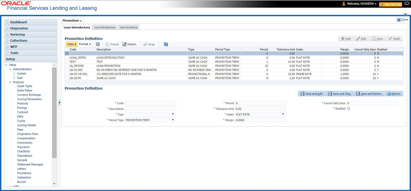

To set up the Loan Introductory
  1. On the Oracle Financial Services Lending and Leasing home screen, click Setup > Setup > Administration > User > Products > Promotions > Loan Introductory.
  2. In the Promotion Definitions section, perform any of the Basic Operations mentioned in Navigation chapter.
    Figure 4-24 Promotions-Loan Introductory
    A brief description of the fields is given below:
    Table 4-59 Promotion Definitions
    Field Do this
    Code Specify the code identifying the promotion.
    Description Specify a description of the promotion being offered.
    Type Select the promotion type from the drop-down list.
    Period Type
    Select the period type from the drop-down list.
    Note: Select PROMOTIONAL DAYS, if the length of the promotion is to be measured in days. Select PROMOTION TERM, if the length of the promotion is more accurately measured in terms.
    Period Specify the specific promotion period. If you have selected PROMOTIONAL DAYS in the Period Type field, then enter the number of days of the promotion period duration. If you selected PROMOTION TERM, then enter the number of terms for which the promotion applies. Remember that the system uses the same length of the term increment that is used in the billing cycle for the loan; for example, weekly, monthly, semi-annual, or annual.
    Tolerance Amt
    Specify the dollar amount of the allowed tolerance, if applicable. This is the amount that can be outstanding at the end of the promotion period.
    Note: This applies only to the promotion type SAME AS CASH.
    Index Select the promotional index rate from the drop-down list.
    Margin Specify the promotional margin rate.
    Cancel Delq Days Specify the tolerance days for the promotion cancellation due to delinquency.
    Enabled Check this box to enable the promotion.
  3. Perform any of the Basic Actions mentioned in Navigation chapter.
