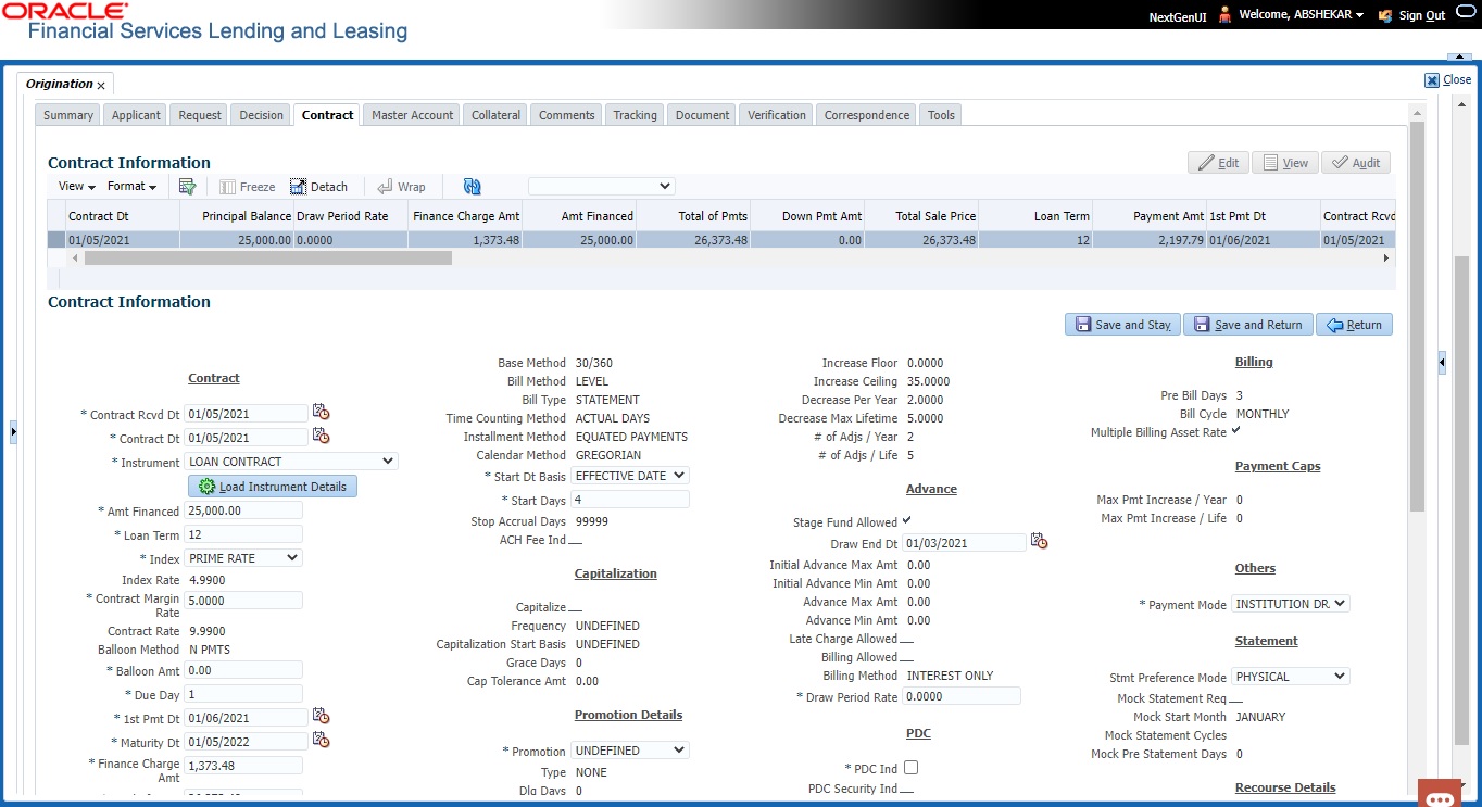

You can use the quick calculator provided with the drop-down list adjacent to the ‘Calculate’ button to calculate the required Loan parameters. You can also use the calculator available in Tools section for completing this step. For detailed information on using the Calculator tools, refer Tools chapter in the document.
While working with the Contract tab for Loan applications, you can either enter the contract details manually or make use of the Suggest option which auto populates the contract and payment details.
- System loads the details of 1st instrument available in Instrument drop-down list.
- Updates the contract date as current GL post date using which all the payment calculations are done.
- Populates decision level contract parameters and Verified By field with User Code.
- Calculates the payment amount.
Since in one click all the required contract information is populated to fund the application, this option helps to improve operational efficiency. But however, this option is not available if the contact instrument is already loaded.

A brief description of the fields is given below:
Table 8-1 Contract
Field Do this Contract section Contract Rcvd Dt Specify the contract received date. Contract Dt Specify the contract date. Instrument Select the required instrument from the drop down list and click on Load Instrument Details. Amt Financed Specify the amount financed: the Loan amount applied minus the prepaid finance charges. Prepaid finance charges can be found on the Good Faith Estimate/Settlement (HUD-1 or 1A). For example, if the borrower’s note is for $100,000 and the prepaid finance charge total is $5,000, the amount financed would be $95,000. The amount financed is the figure on which the annual percentage rate (APR) is based. Loan Term Specify the term/number of payments. Index Select the index. Index Rate View the index rate. Contract Margin Rate Specify the margin rate. Contract Rate View the interest rate. The following 3 fields - Regulatory Name, Regulatory Rate, and Contract Imputed Rate are displayed only if the Imputed Interest check box is selected in Contract Setup (i.e. Setup > Administration > Products > Contract screen).

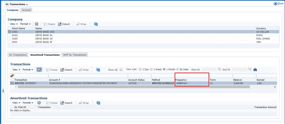

To record the imputed interest amount during loan creation stage, system automatically posts FND IMPUTED INTEREST monetary transaction with total imputed interest amount. In case of loan reversal/cancellation, REVERSE FND IMPUTED INTEREST transaction is posted to post reversal entry on account for imputed interest.
Once the application is funded, the Contract Imputed Rate is propagated to Servicing > Account Details > Contract Information tab.
Figure 8-11 Interfaces-GL Transactions-Imputed Amortization
- Opening balance is updated with total imputed interest amount which is calculated as part of Imputed Interest amortization schedule.
- Transaction = IMPUTED INTEREST, Method = IMPUTED SCHEDULE, and Frequency same as account billing frequency.
If case there is a change in repayment schedule due to change in interest rate, then respective imputed interest rate also changes since the principal changes. Along with this, if there is an early Payoff or account Charge-off, the remaining unearned imputed interest is written-off. On posting monetary transactions which changes the repayment schedule such as Due Date Change, Due Date Change Override, Change Term and so on, system recalculates imputed interest amortization schedule along with repayment schedule and posts an Imputed Interest amortization adjustment transaction.
- IMPUTED INTEREST AMORTIZE and IMPUTED REVERSE INTEREST AMORTIZE
- IMPUTED INTEREST AMORTIZE WRITE-OFF and IMPUTED REVERSE INTEREST AMORTIZE WRITE-OFF
- IMPUTED INTEREST AMORTIZE ADJUSTMENT MINUS and IMPUTED INTEREST AMORTIZE ADJUSTMENT MINUS REVERSE
- IMPUTED INTEREST AMORTIZE ADJUSTMENT PLUS and IMPUTED INTEREST AMORTIZE ADJUSTMENT PLUS REVERSE
