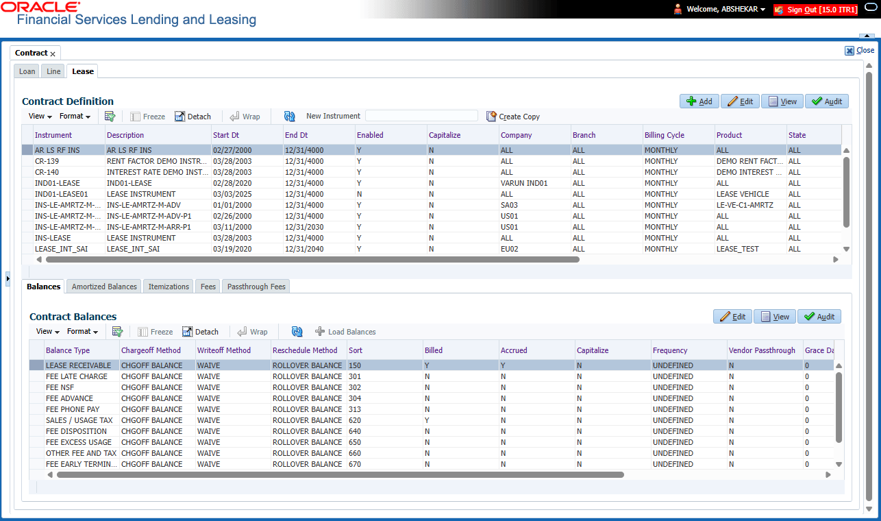

4.4 Contract
The Contract screen allows you to define the instruments used within your system. A instrument is a contract used by a financial organization with specific rules tied to it. When processing an application, an instrument associated with the application informs the system of the type of contract being used for the approved product. This ensures that all parameters tied to the instrument are setup for the account as it is booked - without requiring you to do it.

To set up the Contract
You can either define new Contract Definition details or specify a new name in the New Instrument field and click Create Copy to create a copy of selected contract with details.
  1. On the Oracle Financial Services Lending and Leasing home screen, click Setup > Setup > Administration > Products > Contract > Lease.
  2. On the Contract Definition section, perform any of the Basic Operations mentioned in Navigation chapter.
    A brief description of the fields is given below:
    Table 4-14 Contract Definition
    Field Description
    Instruments section
    Instrument Specify the code identifying the instrument.
    Description Specify the description of the instrument being defined.
    Start Dt Specify the start date for the instrument. You can even select the date from the adjoining Calendar icon.
    End Dt Specify the end date for the instrument. You can even select the date from the adjoining Calendar icon.

    Lease Contract section
    Lease Type
    Select the lease type from the drop-down list. You can select the lease type as either Direct Finance or Operating Lease.
    If the lease Type is selected as Direct Finance, system enables the field Residual Value in Final Bill under Residual Details section for selection.
    Tax Book Type Select the lease tax book type for depreciation from the drop-down list.
    Depreciation section
    In this section you can define asset depreciation method and frequency. The same is used for asset depreciation calculation when the batch job TAMDEP_BJ_121_01 (DEPRECIATION RATE PROCESSING) is executed.
    If asset is associated to an account then an Asset Depreciation amortization transaction is posted on to the account with new delta depreciated value. Asset depreciation is calculated till the entire lease term or till the asset residual amount becomes 0.
    Depreciation Method
    Select the asset depreciation method to be used for calculation as one of the following from the drop-down list.
    • FLAT RATE: This method is used to depreciate the asset over a fixed time using a fixed rate. This method of calculation is similar to Written Down Value Method (Diminishing Balance Method / Reducing Installment Method). On selecting this option, the following fields - Base Rate, Adjusting Rate and Bonus Rate are enabled to define the flat rate.
    • LIFE BASED: This method is used to depreciate the asset over a fixed time using the specified rates. This method of calculation is similar to Straight Line Method (Original Cost Method / Fixed Installment Method). On selecting this option and saving the record, Depreciation Rate Schedule sub tab is enabled to define depreciation rates slab.
    Depreciation Convention Select the frequency at which the leased account should be updated with depreciation details from the drop-down list. The list is populated with frequency details (i.e. monthly, weekly, and so on) maintained in FIRST_LAST_YEAR_CONVENTION_CD lookup code.
    Base Rate If you have selected the Depreciation Method as Flat Rate, specify the estimated base depreciation rate.
    Adjusting Rate
    If you have selected the Depreciation Method as Flat Rate, specify the adjusting rate at which the above base rate should be increased to derive the flat rate of depreciation.
    For example,
    • If base rate is 10 and adjusted rate is 10 then flat rate is 11
    • If base rate is 10 and adjusted rate is 20 then flat rate is 12
    Bonus Rate
    If you have selected the Depreciation Method as Flat Rate, specify the bonus rate (if any) which is additional depreciation allowed on base rate for calculating flat rate depreciation.
    Bonus rate is a tax incentive offered to deduct a percentage of the purchase price of eligible business assets and as a measure of relief for small to medium sized businesses to buy additional equipment.
    For example,
    • If base rate is 10 and bonus rate is 10 then flat rate is 20
    • If base rate is 10 and bonus rate is 2 then flat rate is 12
    Depreciation Rate
    View the system calculated flat rate depreciation value which is calculated as:
    Depreciation Rate% = (Base Rate x (1 + Adjusting Rate/100)) + Bonus Rate.
    Tax section
    Tax Mode Select the tax mode from the drop-down list.
    Tax Method Select the tax method from the drop-down list.
