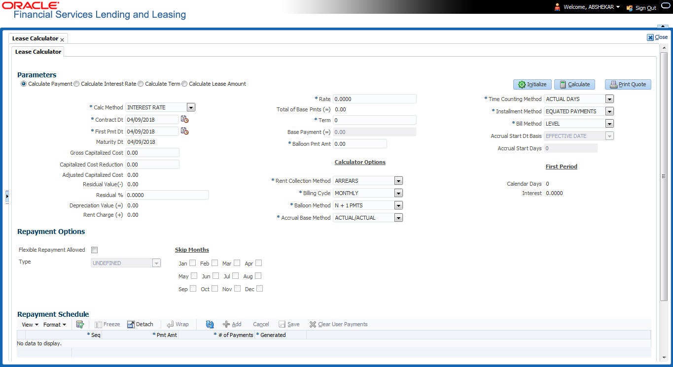

The Lease Calculator screen facilitates user to calculate various lease parameters such as Payment, Interest Rate, Residual Percent, Gross Capitalized Cost, Term and Lease Amount. User can define flexible repayment options, repayment/rate schedule and generate amortization schedules.

  2. In the Parameters section, Calculate Payment option is selected by default and the lease calculation method as Rent Factor. Select the required calculation method and the calculation parameter to display the applicable fields in Lease Calculator screen.
  3. In the Lease Details section, complete the following fields:

  4. In the Lease Calculator section, click Calculate to view the results. User can further proceed with below sections to define flexible repayment options, repayment/rate schedule and generate amortization schedules.
