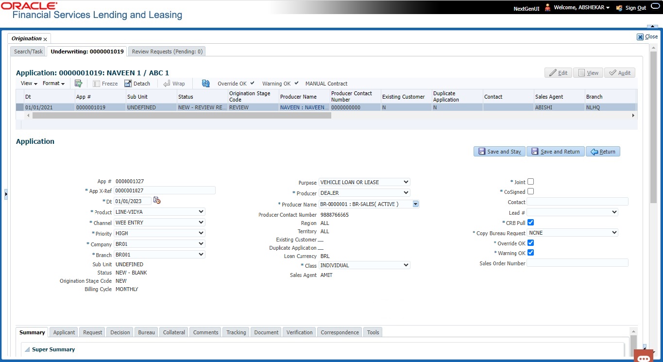

The Underwriting screen’s Applications section appears at the top of the screen opened from Underwriting master tab. The screen displays the application number and name on the header and contains information such as application purpose, product and producer.
In this section, user can perform any of the Basic Operations mentioned in Preface.
Table 7-1 Underwriting screen’s Applications
