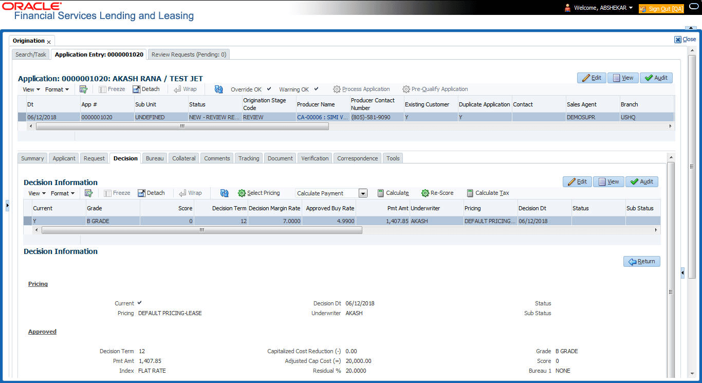

This topic provides information on the decision section. It enables users to view and manage decision details.
If the application was initially approved automatically, the system displays its recommendations on the Decision tab’s Approved section.
If the application was initially rejected automatically, the system displays its reasons on the Decision link’s Stipulation sub tab.
- If the data meets user approval, change the status of the application to either APPROVED or REJECTED and enter any stipulations.
- If user reject the application, change the status to REJECTED and
enter the reasons for the adverse action on the Stipulations sub screen.
user can use the quick calculator provided with the drop-down list adjacent to the Calculate button to calculate the required Lease parameters. User can also use the calculator available in Tools section for completing this step. For detailed information on using the Calculator tools, refer Tools chapter in the document.
- On the Origination, click Origination. Under Origination, click Underwriting.
- Under Underwriting, click
Decision.
The Decision displays.
- Perform any of the Basic Operations mentioned in Preface chapter.
A brief description of the fields is given below:

- Click Select Pricing.
The system determines the best pricing match of all enabled Lease pricing strings in the Setup menu and displays the results in the Pricing and Approved sections.
- Quick CalculateIn the Decision Information section, there is a drop-down list adjacent to the Calculate button with following options to auto calculate different Lease decision parameters based on the data provided. Select the required option from the drop-down list and click Calculate:
Table 7-30 Quick Calculate
Lease Type Calculate Option Rent Factor Calculate Payment
Calculate Residual Percent
Calculate Gross Capitalized Cost
Interest Rate Calculate Payment
Calculate Interest Rate
Calculate Term
Calculate Lease Amount
The system displays the requested calculation in the respective field.
- Re-Score
A Re-Score button is available next to Calculate. Whenever any sensitive Financial or Collateral information is amended in the Application, OFSLL displays a warning message Scoring sensitive information is changed. Re-score the application. User need to click on Re-Score to re-validate the grade and pricing accordingly.
The display of the warning message to Re-score the application can be controlled using the respective System parameter. If the defined System Parameter is flagged Y, only then the message is displayed.
If user are underwriting a Lease, record the following information on the Decision tab:
- If user are approving the application, complete the Approved section with the values user want to approve as an underwriter. User can update the default values that appeared when user selected the pricing string in Step 3. (The system calculator may be of use when completing this section. For more information, refer the Tools chapter).
- Click Calculate Tax. System calculates the Lease Sales and Usage tax for upfront category which is billed during application funding. For more details, refer to Sales Tax Calculation at Origination section in Appendix chapter.
