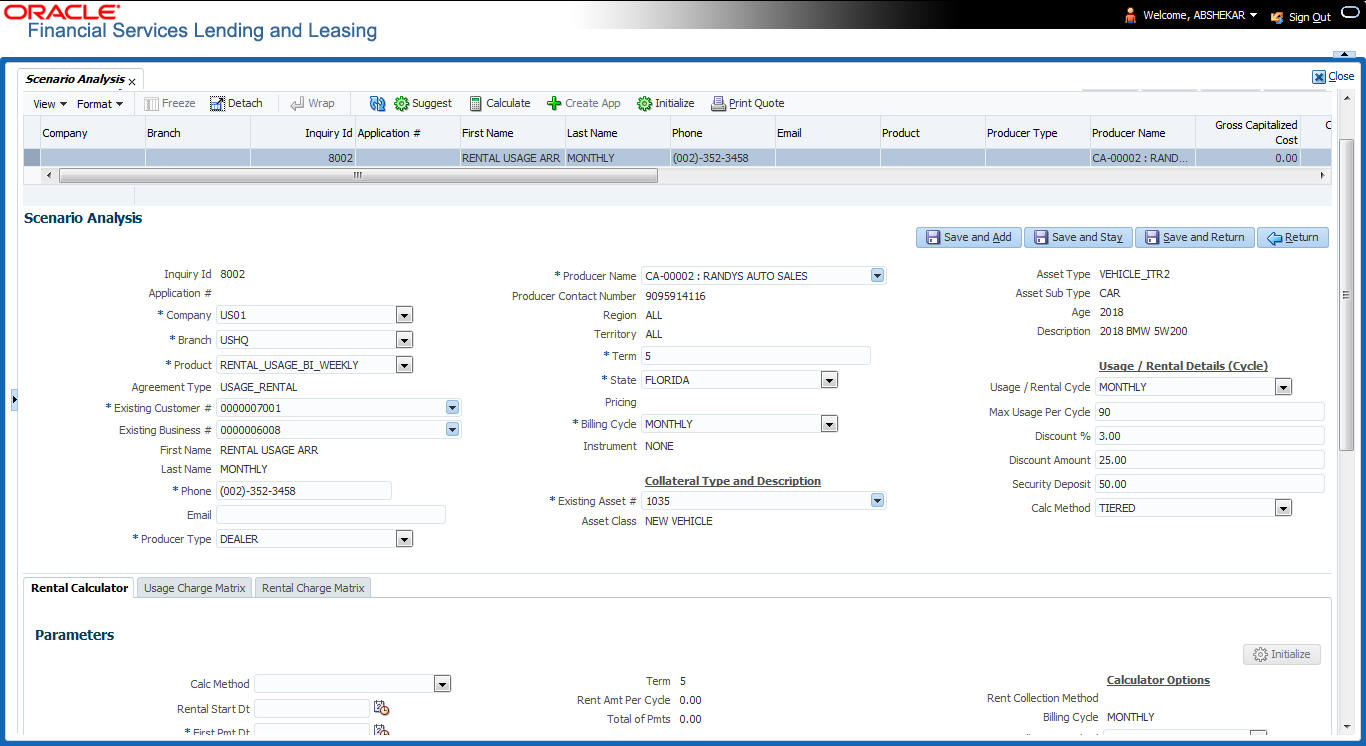

To generate a scenario analysis
  1. On the Origination, click Origination. Under Origination, click Scenario Analysis.
    The Scenario Analysis screen displays.
    Figure 11-1 Scenario Analysis - Lease Calculator
  2. Click Add and complete the following Parameters. User can click Initialize to clear (or refresh) the screen details at any time.
    Table 11-1 Generating Scenario Analysis
    Field Description

    Product
    Select the product from the drop-down list.
    Note: If the selected product is of Lease Rental type, additional fields and sections (indicated below) are enabled and some of the fields are displayed in view mode to define Rental Based lease details. For information on such fields, refer to Rental Agreement section in Application Entry chapter.
    • Additional fields - Existing Customer # and Existing Business #
    • Additional sections - Collateral Type and Description, Usage / Rental Details (Cycle)

  3. In the Lease Calculator section, user can specify the details of various Parameters, Repayment Options, and Amortization Schedule.
    For detailed field information, refer to Lease Calculator section inTools chapter.
  4. After user have specified all the required details, click Calculate.The system computes the standard payments with the details specified.
