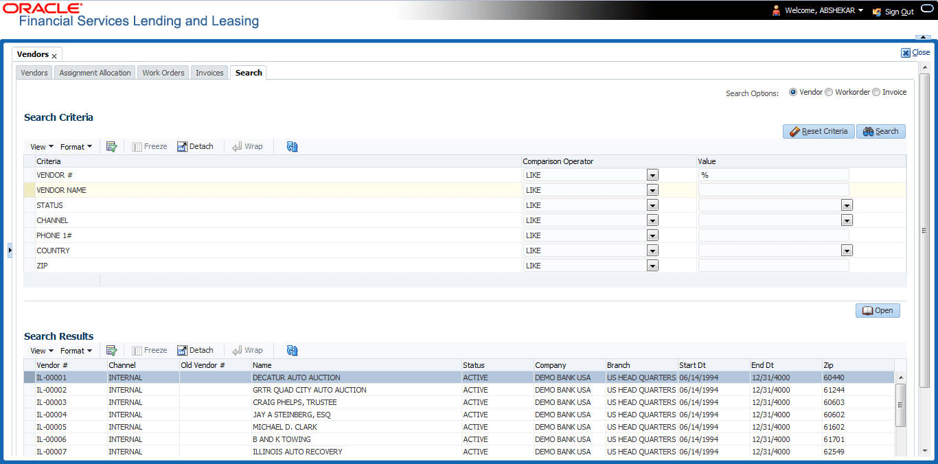

A Search tab is available on the Vendors screen to help locate the details of a Vendor, Workorder, and/or an Invoice information maintained in the system. This is the information that is used in the respective tabs of Vendors screen.
To search for a Vendor/Workorder/Invoice
  1. On the Servicing, click Servicing. Under Servicing, click Vendors. Under Vendors, click Search.
    The Search screen displays.
  2. In the Search Options, select the option against Vendor or Workorder or Invoice.
  3. In the Search Criteria section, use Comparison Operator and Value columns to enter search criteria user want to use to locate a producer.
  4. Click Search.
    System displays the result in the Search Results section at the bottom of the screen with the following details:

  5. Select the required record and click Open. The details of only that particular Vendor / Workorder / Invoice is displayed in the respective tab of Vendors screen. However, system displays the selected record details only for authorized users based on access/ permissions defined in setup.
    When a single producer record is opened from Search tab, the Vendors / Work Orders / Invoices tab enables a Remove Filter option. Clicking on the same removes the filter criteria and displays all the corresponding records maintained in the system.
User can click Reset Criteria at any time to clear Comparison Operator and Values columns on the Search Criteria section.
