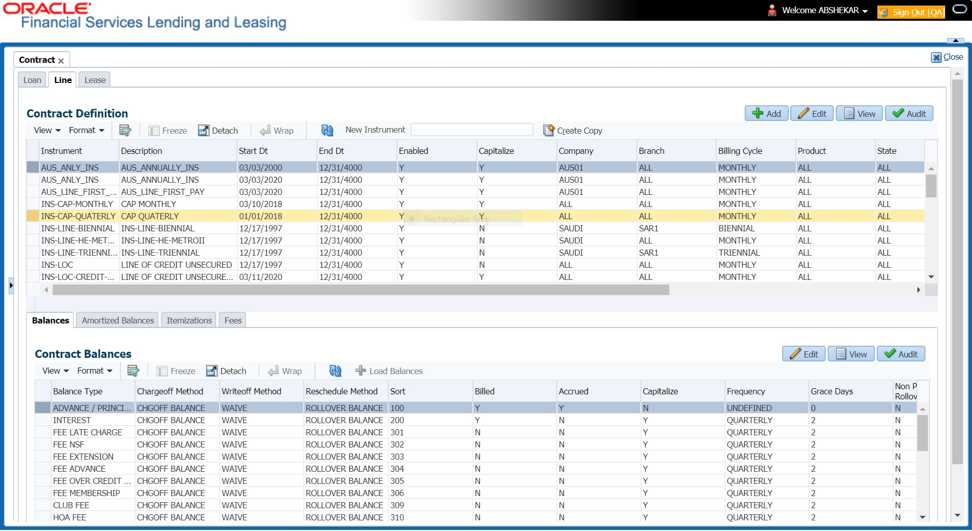

To set up the Contract
You can either define new Contract Definition details or specify a new name in the New Instrument field and click Create Copy to create a copy of selected contract with details.
  1. On the Oracle Financial Services Lending and Leasing home screen, click Setup > Setup > Administration > Products > Contract > Line.
  2. On the Contract Definition section, perform any of the Basic Operations mentioned in Navigation chapter.
    A brief description of the fields is given below:
    Table 4-13 Contract Definition
    Field Do this
    Instruments section
    Instrument Specify the code identifying the instrument.
    Description Specify the description of the instrument being defined.
    Start Dt Specify the start date for the instrument. You can even select the date from the adjoining Calendar icon.
    End Dt Specify the end date for the instrument. You can even select the date from the adjoining Calendar icon.
    Enabled
    If you check this box, the system will consider this contract definition when selecting a instrument for an application.
    Note: Once the field is enabled load balances button in balances sub tab will be disabled.
