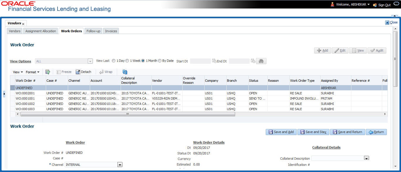

The Work Order screen displays.
- Sort the list of work orders based on status using the View Options drop-down list. User can further sort the list of work orders based on elapsed days by selecting the View Last option as 1 Day / 1 Week / 1 Month / By Date. When By Date is selected user can specify a date range (within 3 months) in Start Dt and End Dt fields using the adjoining calendar and clicking Search.

A brief description of the fields is given below:
Table 14-8 Work Orders
Field Description Work Order # Displays the work order number. Case # Displays the case number received from third party vendor interface. Channel Select the OFSLL interfaced channel from the drop-down list. If the channel is selected as GENERIC RECOVERY INTERFACE, the work order is processed through an external system. For more information, refer to Appendix chapter - Appendix : Generic Recovery Interface (GRI).
Work Order Type Select the work order type from the drop-down list. Account Select account number for the work order from the drop-down list. Company Displays the company name based on the account selected. Branch Displays the branch based on the account selected. Vendor Select vendor who will service the work order from the drop-down list. The list of vendors are displayed based on the selected Channel, Work Order Type, and Account. Override Reason In case of vendor re-assignment, select the appropriate override reason for the selected Vendor. Status Select the work order status from the drop-down list. If the status is selected as SEND TO GRI, the work order is processed through an external system. For more information, refer to Appendix chapter - Appendix : Generic Recovery Interface (GRI).
Reason This field is enabled only if the status of work order is selected as PENDING ON HOLD, RLRELEASED, or PENDING CLOSE. User can select the appropriate reason from the drop-down list. Collector Select the Collector from the drop-down list. The list displays all the users defined with Collector responsibility. Work Order Details Displays the work order details section. Dt Displays the date when work order was created. Status Dt Displays the last work order status-change date. Currency Displays the vendor company currency based on the vendor selected. Estimated Displays the estimated amount, which is the sum of all the services added to the work order. Billed Displays amount billed by the vendor for the work order. Paid Displays amount paid to the vendor for the work order. Reference # Specify vendor reference details if any. Assigned By Displays the user who created/assigned the work order to vendor. Followup Dt Select the subsequent follow-up date from adjoining calendar. Account Information System displays the following information depending on the account selected for the work order in Work Order section. Account Status Displays the status of the account. Charged off Dt Displays the date when the account was charged off. Due Amt Displays the due amount to be paid to the account. Total Outstanding Balance Displays either Account outstanding principal balance for active accounts, or Deficiency balance for charge-off accounts. Total Due Displays the total of all dues pending on the account. Due Dt Displays the last elapsed due date on the account. Days Past Due Displays the total number of days elapsed past due date. Service Address Displays the combined details of Customer/Business, Address Type and Address based on the account selected. For Business account only business address is populated. User can also select the required service address from the drop-down list only while creating work order details (i.e. when status = New).
Note: When selecting the service address for an external interfaced channel (i.e. changing primary address), ensure to select the secondary address only. Else, system displays an error message.
Collateral Details This section displays the asset details associated with the work order. Collateral Description System displays the primary collateral associated with the account by default. User can also select the collateral from the drop-down list. The list displays all the assets associated with the account. Identification # Displays the identification number of the asset. Year Displays the manufacturing year of the asset. Make Displays the asset’s manufacturing company. Model Displays the asset’s model. Vendor Information Displays the vendor information section. Contact Specify the vendor contact for the work order. Phone Specify the vendor contact phone for the work order. Extn Specify the vendor contact phone extension for the work order. Fax Specify the vendor contact fax for the work order. Comment Specify any comments regarding the work order. Vendor Messages This section is displayed only when the selected channel is GENERIC RECOVERY INTERFACE and allows user to add specific communication or instructions as a message to the vendor. Vendor Msg Type Select the type of vendor message from the drop-down list. Vendor Msg Specify additional information that is to be communicated to the external interface. - Perform any of the Basic Actions mentioned in Preface.
