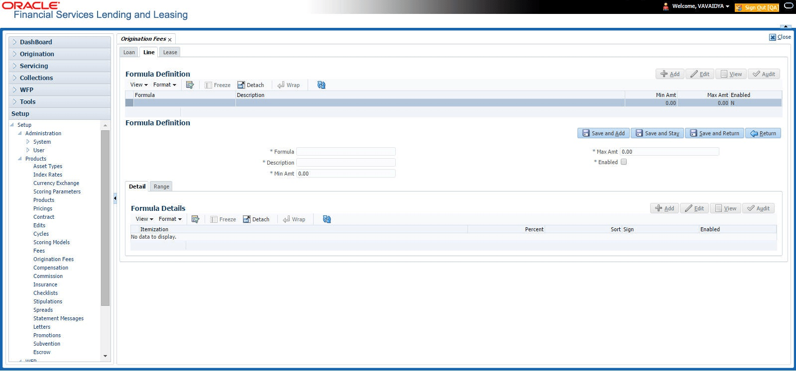

- On the Oracle Financial Services Lending and Leasing home screen, click Setup > Setup > Administration > User > Products > Origination Fees > Line.
- In the Formula Definitions section, perform any of the Basic Operations mentioned in Navigation chapter.
- A brief description of the fields is given below:
Table 4-42 Formula Definitions
Field Do this Formula Specify the formula code to define computation. Description Specify the description for the formula. Min Amt Specify the minimum value that should be considered to compute the final value of formula. Max Amt Specify the maximum value that should be considered to compute the final value of formula. Enabled Check this box to allow the origination fees. - Perform any of the Basic Actions mentioned in Navigation chapter.
- In the Formula Details section of Setup > Setup > Administration > User
> Products > Origination Fees > Line > Detail,
Table 4-43 Formula Details
Field Do this Itemization Select the itemization based on which the itemization formula will derive its computed value, from the drop-down list. Percentage Specify the percentage value that should be considered while computing value for itemization formula. Sort Specify the sort sequence for the itemization to be considered while computing the value of the itemization formula. Sign Select the +ve or -ve sign that needs to be considered between two itemizations for computing the value of the itemization formula. Enabled Check this box to allow the itemization details to be used by the system. - Perform any of the Basic Actions mentioned in Navigation chapter.
- In the Range Details section of Setup > Setup > Administration > User
> Products > Origination Fees > Line, perform any of
Table 4-44 Range Details
Field Do this Amt From Specify the value up to which the percentage of final value of the itemization formula to be considered for the final value of itemization formula. Percent Specify the percentage value that should be considered while computing the value for the final value of the itemization formula. Enabled Check this box to allow the range details to be used by the system. - Perform any of the Basic Actions mentioned in Navigation chapter.
