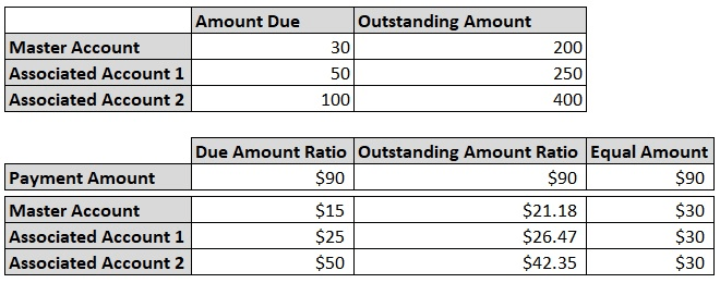

Following is an illustration on payment allocation:
Description of administrationuser-paymenthierarchy-illustration21.png follows
Description of the illustration administrationuser-paymenthierarchy-illustration21.png
