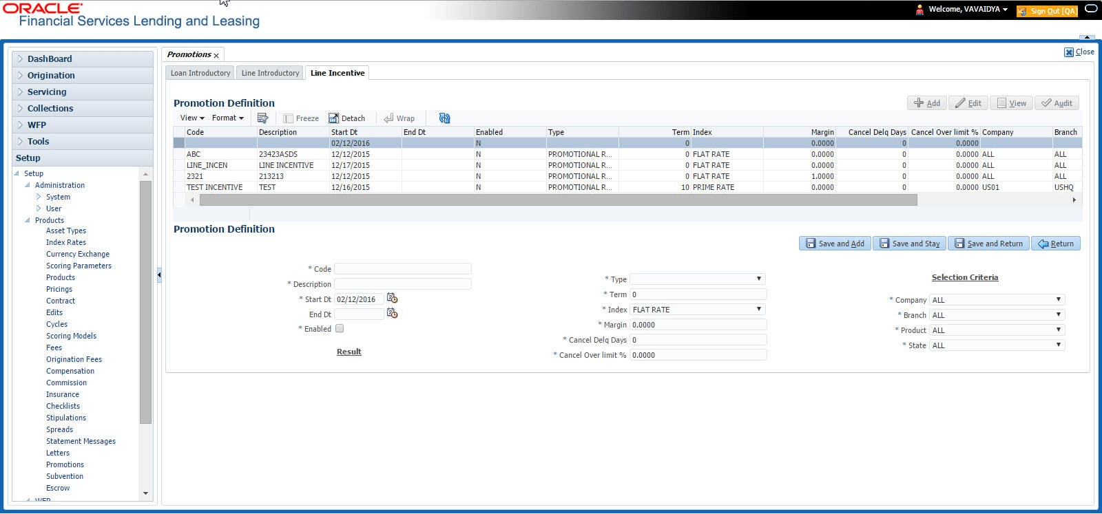

  4. On the Oracle Financial Services Lending and Leasing home screen, click Setup > Setup > Administration > User > Products > Promotions > Line Incentive.
  5. In the Promotion Definitions section, perform any of the Basic Operations mentioned in Navigation chapter.
    Figure 4-21 Promotions-Line Incentive
  6. A brief description of the fields is given below.
    Table 4-55 Promotion Definitions
    Field Do this
    Code Specify the code identifying the promotion.
    Description Specify a description of the promotion being offered.
    Start Date Select the start date from the drop-down list.
    End Date Select the end date from the drop-down list.
    Enabled Check this box to enable the promotion.
    Result section
    Type Select the promotion type from the drop-down list.
    Term Specify the promotion term.
    Index Select the promotion index from the drop-down list.
    Margin Specify the promotion margin rate.
    Cancel Delq Days Specify the promotion cancellation delinquency days.
    Cancel Overlimit% Specify the promotion cancellation over limit percentage.
    Selection Criteria section
    Company Select the portfolio company from the drop-down list.
    Branch Select the portfolio branch from the drop-down list.
    Product Select the product from the drop-down list.
    State Select the state from the drop-down list.
  7. Perform any of the Basic Actions mentioned in Navigation chapter.
