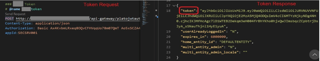

    The following additional fields are enabled for ORACLE BANKING ROUTING HUB (OBRH) type of Authentication mode:
    User Name Specify the third-party OBRH Resource Owner User Name.
    Password Specify the third-party OBRH Resource Owner Password.
    Token Header Key Specify the token header key of third-party OBRH client.
    Response Token Key
    Specify the Response Token Key of third-party OBRH client which is the key name of Authentication Response Header. The same is used to identify token value used as input for subsequent calls.
    Note: If value is not provided, system defaults to access_token. An example is indicated below where token element is the key name:
    Description of response-token-key.png follows

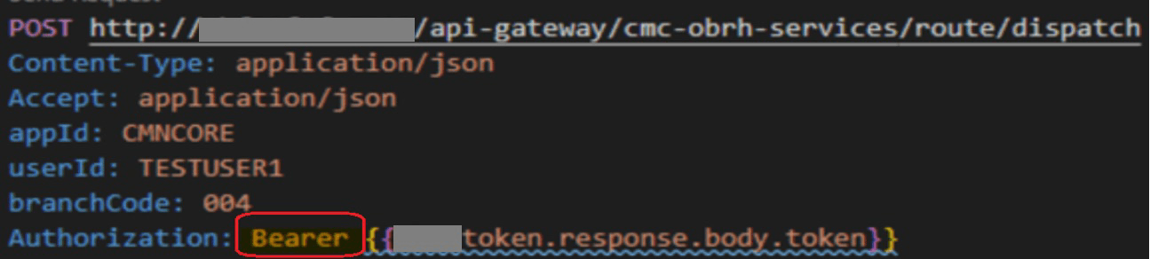

    Request Authorization Header Prefix
    Specify the Request Authorization Header Prefix of third-party OBRH client This is the prefix used to Request Authorization Header based on token generation mechanism like Basic, Bearer, JWT and so on.
    Note: If value is not provided, system defaults to Bearer. An example is indicated below:
    Description of request-authorization-header-prefix1.png follows
