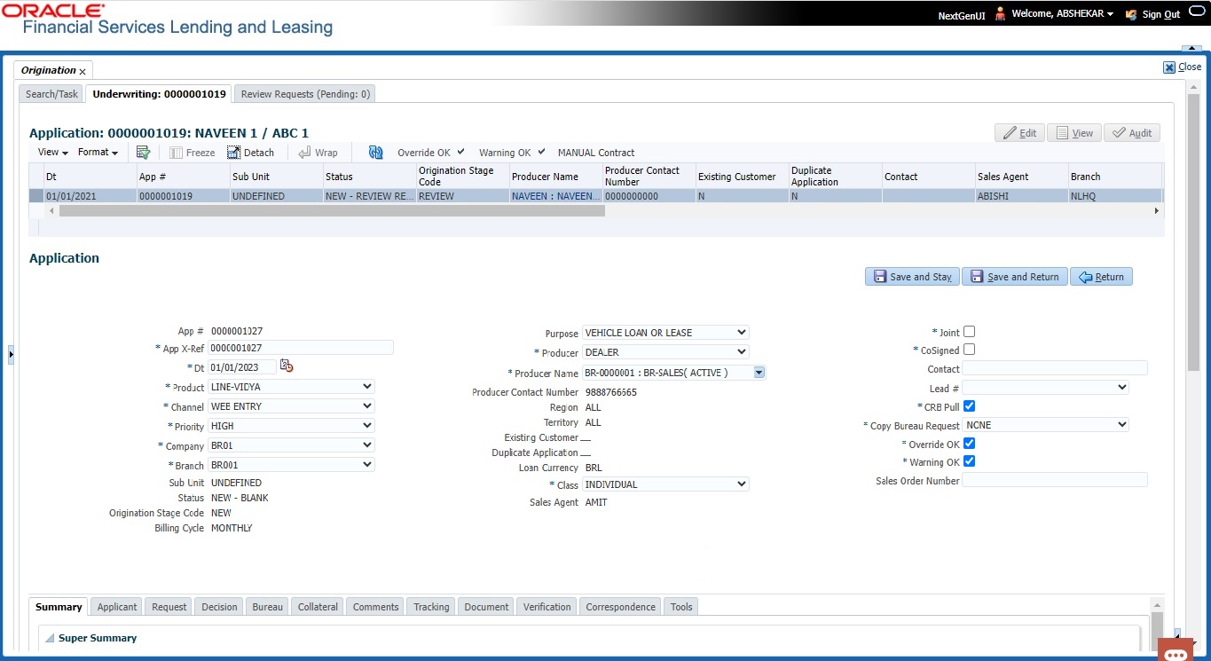

The Underwriting screen’s Applications section appears at the top of the screen opened from Underwriting master tab. The screen displays the application number and name on the header and contains information such as application purpose, product and producer.

Table 7-1 Underwriting screen’s Applications
| Field | View this |
| App # | The application number |
| App X-Ref | If auto updated, then indicates that it is the application number generated from external system. While adding an application, the default value is updated as UNDEFINED. It is mandatory to populate the X-Ref number during application entry. However, there are no validations on the format but while saving the record, the value = UNDEFINED is replaced with 'Application Number' generated by the system. |
| Dt | The application date |
| Product | The Line of credit product of the application. |
| Channel | How the application information was received. |
| Priority | The priority of the application. |
| Company | The company of the application. |
| Branch | The branch of the company. |
| Status | The status of the application. |
| Origination Stage Code | The origination stage code of the application. |
| Billing Cycle | The billing cycle of the application. System displays the applicable billing cycle by default based on the product and the calculation method defined at Setup click Products screen. The editable nature of billing cycle is controlled by the system parameter UIX_BILL_CYCLE_ALLOWED_ IND. However, for Rent Factor type of lease calculation, only ‘Monthly’ is applicable and system displays an error on save if any other value is selected. |
| Purpose | The purpose of the application. |
| Producer |
The producer type and producer of the application. The Producer drop-down list displays all the Producers maintained in lookup code PRO_TYPE_CD (PRODUCER TYPE CODES). Since the Company and Branch of the account and Producer need not be the same, user can select any Producer across all branches of the company to which the account belongs. This implies that a common Producer belonging to a company can be specified to accounts which belong to different branches but the same company. |
| Producer Name | The name of the producer of the application. The Producer Name is displayed as a hyperlink and clicking on the same will open Producers page with details of the producer. |
| Producer Contact Number | The system displays the contact number of the producer. |
| Region | The region of the producer. |
| Territory | The territory of the producer. |
| Existing Customer | Indicates if the customer is an existing customer. |
| Duplicate Application | Indicates if the application is a duplicate application. |
| Line of credit Currency | The Line of credit currency of the application. |
| Class | The class of the application. |
| Sales Agent | The sales agent of the application. |
| Contract Type | The type of application. Manual indicates OFSLL generated application, where as eContract/Dealer indicates that application is generated from external system. |
| Joint | If selected, indicates this is a joint application. |
| Cosigned | If selected, indicates this is a co-signed application. |
| Contact | The contact of the application. |
| Lead # | The lead number will appear in the list only if a lead is already created using the Sales Lead link. |
| CRB Pull | Check this box to pull an initial credit bureau report, after the application passes the pre screen edits. Uncheck the box, if user want to enter an application without pulling a credit report. To use a previously pulled credit bureau report, uncheck this box and specify the Bureau and Bureau Reorder # fields on the Primary Applicant screen. |
| Copy Bureau Request |
This option is enabled only, if CRB Pull check box is selected and facilitates to copy and re-use the existing customer bureau details maintained in the system to new applicant. System supports copying of bureau details of both individual customer as well as business entity and for primary and secondary applicants. Select one of the following option from the drop-down list: NONE - If selected, system does not copy existing customer bureau details and has to be manually handled during decision stage. COPY LATEST - If selected, system copies the existing customer bureau details if the same is available within the time frame configured in system parameter. DAYS_TO_PULL_CRB_REPORT. However, if no bureau details are available within configured time frame of system parameter, system automatically triggers for new bureau pull. |
| Override Ok |
Check this box to ignore the overrides. If the application has been marked as Override OK then the system would allow user to change the application status even when override condition exists. |
| Warning Ok |
Check this box to ignore the warnings. If the application has been marked as Warning OK then the system would allow user to change the application status even when warning exists. |
| Proxy for Underwriter |
If user are acting as a proxy for an Underwriter, then user can select the Underwriter’s name from the adjoining options list. The list displays all the associated Underwriters, Underwriting Supervisors, and Underwriting Managers. However, this is not mandatory and can be used while auctioning an application on behalf of another underwriter. |
| Sales Order Number |
If user have a Sales Order Number which is to be associated to the application, specify the same. User can enter a unique alpha-numeric number up to 80 characters. Note: User can also enter Null or even blank value. On funding, this Sales Order Number is associated to the account and in-turn helps to group all those accounts with the same sales order number. For more information, refer to this field in Servicing module. |
