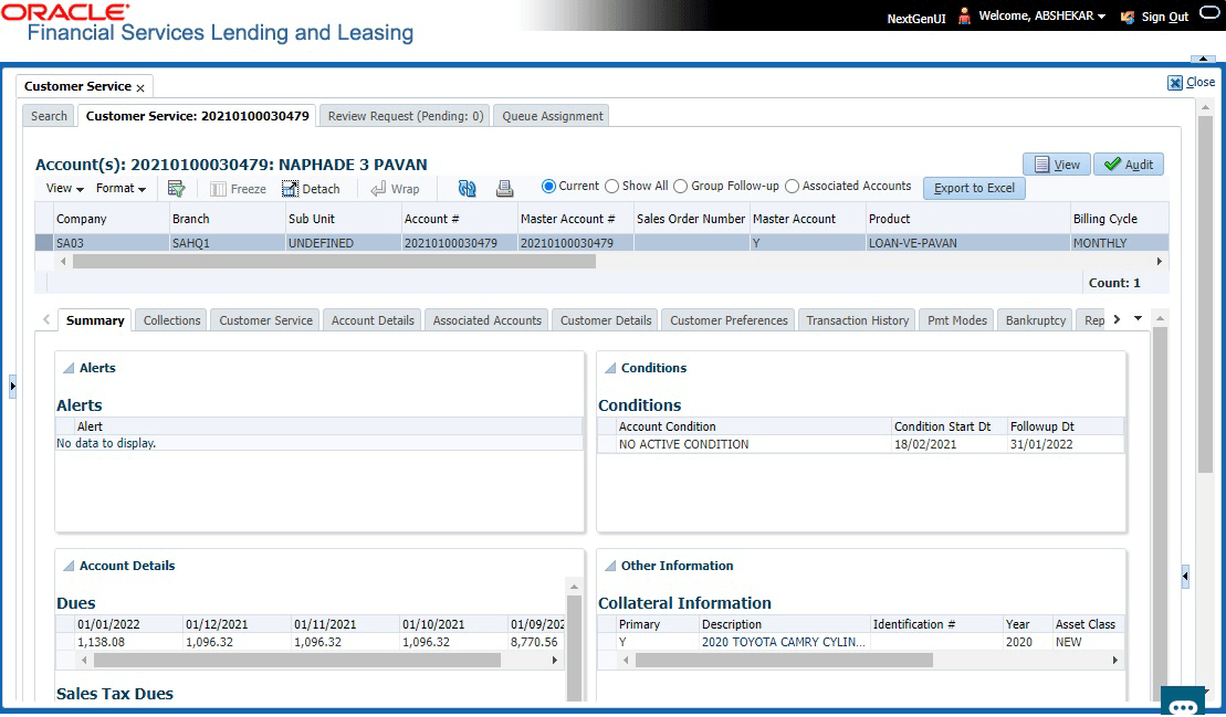

4.3 Customer Service screen’s Summary Tab
Open Customer Service screen and load the account you want to work with. By default the Customer Service screen opens the Summary tab.
Figure 4-2 Customer Service Summary tab
Alerts section
Any comment posted as an alert, are displayed in the alert section of Summary tab.
Conditions section
You can view any conditions like Bankruptcy, Repossession, Foreclosure etc posted on an account. The condition is posted in the account with a start date which is the effective date and follow up date which indicates the next follow-up date for further process.
For newly funded account, a default condition is posted as NO ACTIVE CONDITION. This condition is available in the Queue Criteria drop-down to create Queue of Accounts with NO ACTIVE CONDITION. On posting any other condition on the account, this default condition is replaced automatically and an entry is updated in Account Details > Condition Details > Condition/Queue History tab.
Dues section
Unpaid dues and the dates are displayed in a tabular form. Details of payment amount due, fee due, payoff are also displayed.
