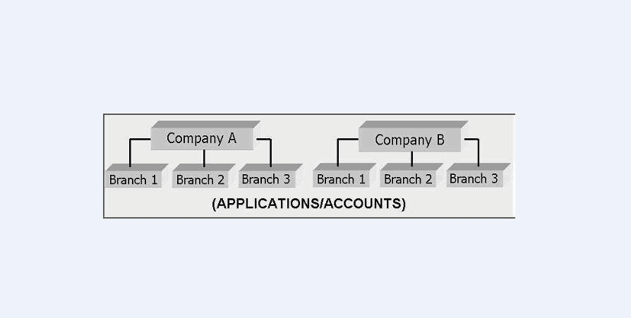

The Companies screen records the hierarchical structure of your portfolio companies and their branches. Just as Oracle Financial Services Lending and Leasing uses the Organization screen to determine the location of people, it uses the information on the Companies screen to determine the location of applications. In completing the Companies screen, there can be more than one company, and each company can have more than one branch.
Accounting is performed at the company level. applications can be sorted down to the branch level. For this reason, branches are set up to reflect different business practices. You would set up different branches if, for example:
  • The General Ledger (GL) differs between branches
  • The branches work with different accounts
  • There is a difference between branches in terms of the tasks they perform (origination, servicing, collections, and so on).

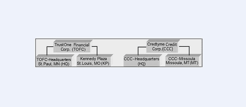

    As an example of the companies setup, Oracle Corp. might have the following companies and branches defined as:
    Company: C-0001TrustOne Financial CorpTOFC
    Branch: CB-01TOFC - HeadquartersHQ
    Branch: CB-02Kennedy Plaza KP
    Company: C-0002Credtyme Credit CorpCCC
    Branch: CB-11CCC - HeadquartersHQ
    Branch: CB-12CCC - MissoulaMT

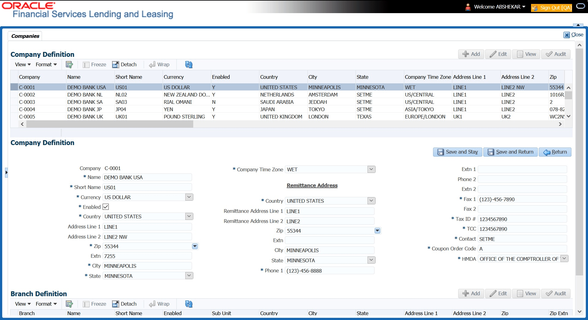

    To setup the Companies
    1. Click Setup > Setup > Administration > User > Companies. The Companies screen defines entities within your organization that originate and/or service Loans.
    2. In the Company Definition section, perform any of the Basic Operations mentioned in Navigation chapter.
      A brief description of the fields is given below:
      Table 3-5 Company Definition
      Field Do this
      Company Specify the portfolio company ID. (This ID is the unique identifier used internally by the system to represent the company).
      Name Specify the name of the portfolio company (required).
      Short Name Specify the short name for the portfolio company (ID displayed to represent the company).
      Currency Select the currency of the portfolio company from the drop-down list. The system displays the default value as US DOLLAR.
      Enabled Check this box to enable the portfolio company.
      Country Select the country where the portfolio company is located from the drop-down list. The system displays the default value as UNITED STATES.
      Address Line 1 Specify the address line 1 for the portfolio company.
      Address Line 2 Specify the address line 2 for the portfolio company.
      Zip Select the zip code of the location where the portfolio company is located from the drop-down list.
      Extn Specify the extension of the zip code where the portfolio company is located.
      City Specify the city where the portfolio company is located.
      State Select the state where the portfolio company is located from the drop-down list.
      Company Time Zone Select the time zone in which the company operates using the drop down list. This time zone is considered if system is setup to process GL at Company level. For more information, refer to Appendix - Configuration at Company Level chapter.
