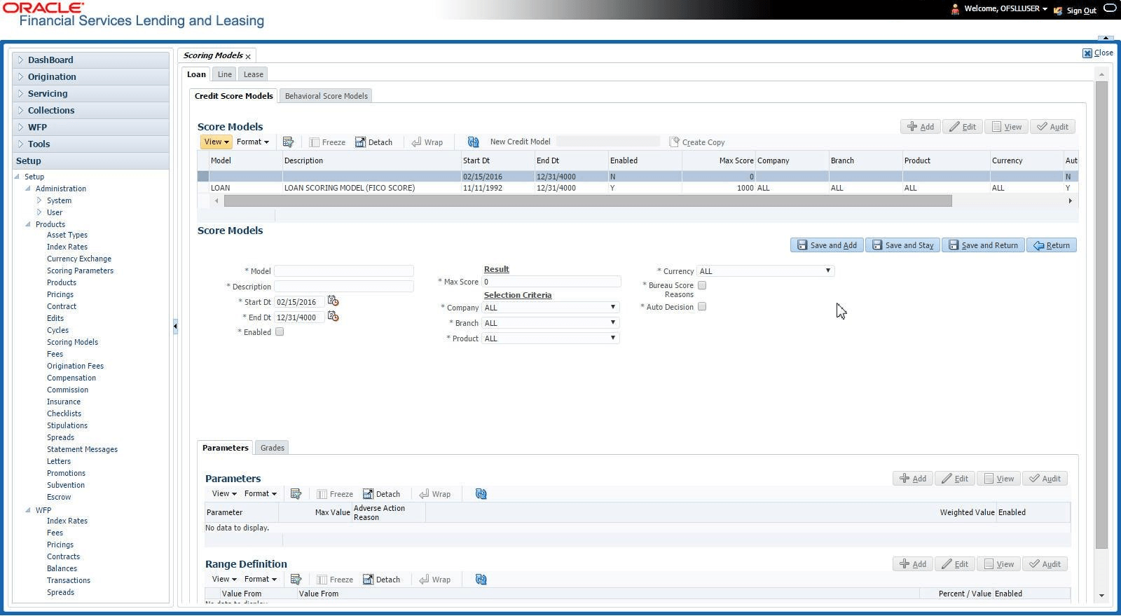

4.11.1 Credit Score Models
- Click Setup > Setup > Administration > User > Products > Scoring
Models > Loan > Credit Score
Models.
- In the Score Models section, perform any of the
Basic Operations mentioned in Navigation chapter.
A brief description of the fields is given below:
Table 4-34 Score Models
Field Do this Model Specify the code for the scoring model. Description Specify a description of the scoring model. Start Dt Specify the start date for the scoring model. You can even select the date from the adjoining Calendar icon. End Dt Specify the end date for the scoring model. You can even select the date from the adjoining Calendar icon. Enabled Check this box to enable the scoring model. Results section Max Score Specify the maximum score allowed. (This is normally the sum of the Max Value fields within the scoring parameters.). Selection Criteria section Company Select the company for the scoring model, from the drop-down list. This may be ALL or a specific company. Branch Select branch within the company for the scoring model, from the drop-down list. (This may be ALL or a specific branch. However, if you have selected ALL in Company field, then you must select ALL for this field). Product Select the product for the scoring model, from the drop-down list. This may be ALL or a specific product. Currency Select the currency for the scoring model, from the drop-down list. This may be ALL or a specific currency. Bureau Score Reasons Check this box to use the score reasons supplied by the credit bureau. If unchecked, then automatically rejected applications scored using this scoring model display the Adverse Action Reasons from the Parameters sub screen. Auto Decision Check this box to assign an application, a status/sub status based on the grade associated with the score returned for this scoring model. If not selected, the system assigns applications scored using this scoring model a status/sub status of NEW-REVIEW REQUIRED.
