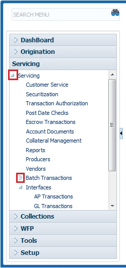

Left Window
In the left pane, system lists and provides drop-down links for various modules available in the product. Click Drop-down link to expand the Module Master Tabs and Drop-down link to collapse them.
To open a screen, navigate to Module Master Tab to which the screen belongs, expand the tabs, and click the screen link user wish to open.
Menu Search in Left Window
In the left window user can make use of the search option to directly search and open the screen that user are familiar with, and avoid multiple steps of navigation from the LHS menu.
The Search box in the LHS facilitates for an intuitive search of required screens in Oracle Financial Services Lending and Leasing. For example, on typing the first letter of the screen, the search box displays a list of all available screens starting with the letter entered in alphabetical order. User can click on the required screen and press Enter. The screen is displayed in the main window/work area.
When there are multiple matches with same screen name, user can filter the results through the module from which the screen is accessed which is indicated in angular brackets. For example typing VEN displays the following options for selection - Vendors(Collections), Vendors(Origination), Vendors(Servicing), Vendors(Setup System). For subsequent search, user need to clear the data in the search field.

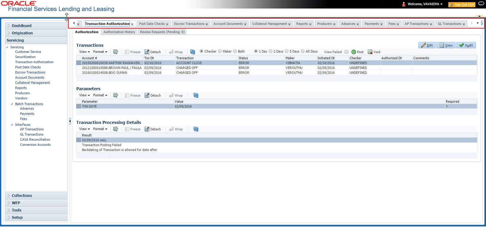

Right Window
The Right Window can also be termed as work area. When user click the screen link on left pane, system displays the corresponding screen in the right pane.
User can open a maximum of 15 screens at a go. Once the maximum limit is reached, the system displays an error message.
Each active screen is displayed as a tab at the top of right pane, across its width. To view a screen, click the screen tab. User can identify the active screen with its white background. Also, operation on any of the screen will not affect the data in other screens.

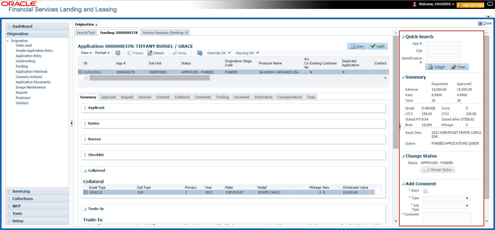

Origination Screens
  1. Navigate to Origination, click Origination. Under Origination, click Funding.
    The user can use the Right Splitter/Action Window to do the following:
Figure 1-12 Right Split Window Application
Table 1-4 Quick Search
Field Description
Quick Search It displays the Quick Search section.
App# Enter the unique Application Number to quickly search for a specific application.
SSN Enter the last 4 digits of the applicant’s Social Security Number for application lookup.
Identification # If multiple applications or accounts are found during Identification # search, the system displays an error message as “Multiple Matches found for the Identification #, Please use normal Search”.
Submit Click to execute the search based on the entered criteria.
Clear Click to reset the entered search fields for a new search.
Summary Summary section displays critical information that has to be referred repeatedly during origination like – DTI, PTI, Book Value, Grade, FICO Score, Approved Advance, Rate and Term.
Change Status Use Change Status section to change the application status to next level. If the application edit status is restricted, then the Change Status will be read-only.
Add Comment Use Add Comment section to post an alert or comment during Underwriting and Funding stages.
For detailed information on the above options, refer to respective sections in the document.

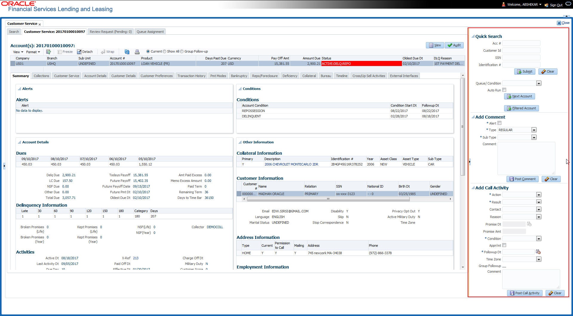

Servicing and Collection Screens
  1. Navigate to Servicing and Collection, click Servicing and Collection. Under Servicing and Collection, click Customer Service.
Figure 1-13 Right Split Window Customer Service
Table 1-5 Quick Search
Field Description
Queue/Condition Select a processing queue or account condition to filter the search results.
Auto Run Check this if user want the search to execute automatically when fields are filled.
Next Account Click next account button opens the subsequent account listed in search.
Filtered Account Click Filtered Account opens the subsequent account fetched during a queue search and listed in Queue Assignment section.
Add Call Activities Use Add Call Activity section to post all types of call activities including promise to pay, account conditions and so on, irrespective of the screen user are working on. This is similar to the option available in Call Activities sub tab under Customer Service tab.
