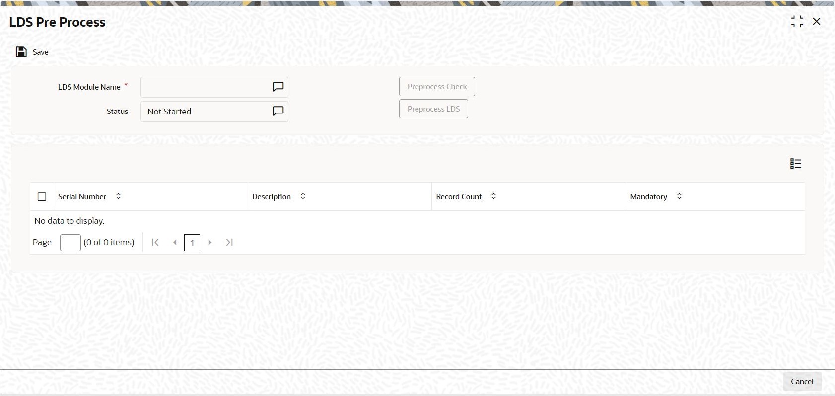

- On Home screen, type LDPREPRC in the text box, and click Next.The LDS Pre Process screen is displayed.
- On LDS Pre Process screen, click New to enter the details.For more information on fields, refer to the field description table.
Table 2-2 LDS Pre Process - Field Description
Field Description LDS Module Name Display
The system displays the LDS module name on click of New button.
Status Display
The system displays the status on click of New button.

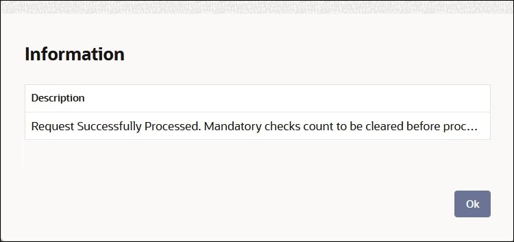

- Click Preprocess Check to validate the cut-off date. Click Preprocess Check button, the system will execute few check queries and return the count.Once the request is successful, the following confirmation window is displayed.
Figure 2-4 LDS Pre Process_Preprocess Check Button_Information Message
- Click Ok.The following details are displayed:
- Serial Number
- Description
- Record Count
- Mandatory
- Clear the mandatory check count before proceeding with pre-process execution once the request is processed successfully.

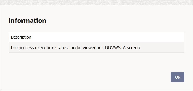

- Click Preprocess LDS button which is enabled once count is cleared to initiate pre-process job.The following information window is displayed:
Figure 2-5 LDS Pre Process_Preprocess LDS Button_Information Message
- View the pre-process execution status in LDS Status
screen by selecting the stage as Preprocess and click
Enter Query.
