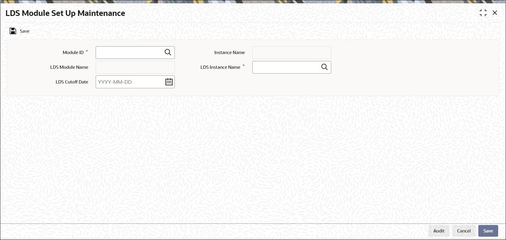

  1. On Home screen, type SMDLDMOD in the text box, and click Next.
    The LDS Module Set Up Maintenance screen is displayed.
    Figure 2-1 LDS Module Set Up Maintenance
  2. On LDS Module Set Up Maintenance, click New to enter the details.
    Table 2-1 LDS Module Set Up Maintenance - Field Description
    Field Description
    Module ID
    Alphanumeric; 30 Characters; Mandatory
    Specify the module ID. Alternatively, you can select the module ID from the option list. The list displays all valid module ID and instance name maintained in the system.
    Instance Name
    Display
    The system displays the instance name for the selected module ID.
    LDS Module Name
    Display
    The system displays the LDS module name.
    LDS Instance Name
    Alphanumeric; 50 Characters; Mandatory
    Specify the LDS instance name. Alternatively, you can select the LDS instance name from the option list. The list displays all valid LDS instance name maintained in the system.
    LDS Cutoff Date
    Date Format; Mandatory
    Select the LDS cut-off date from the adjoining calendar.
    Note: The LDS Cutoff Date can be product fiscal end date or a date lesser than the fiscal end date. If LEP is not installed, then LDS Cutoff Date can be a date minimum of 2 years less than the application date.
  3. Click Ok and then click Save to save the entered records.
    Only one active setup can be maintained for a module.
